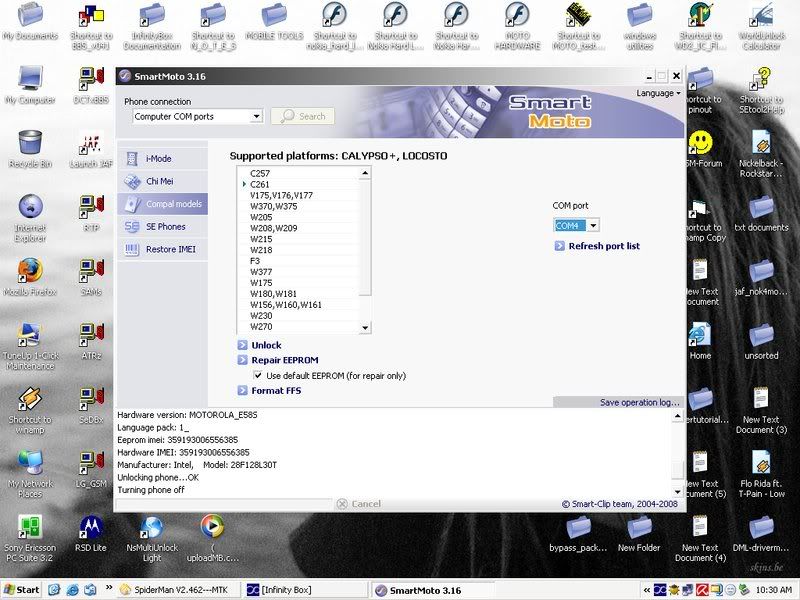

Smart-Clip / C261 repair eeprom then unlock done
« on: September 08, 2008, 08:33:37 AM »
Problem: Hang on motorola logo due to bad unlocking
Action taken: Repair eeprom and unlocked the unit
eeprom repair:
unlock:
SmartMoto 3.16
S-Card: :D Smart-Clip dongle, v 2.10, assigned Smart-Clip::D Europe, initializing... OK
Waiting for the phone to power on...OK
Sending boot...OK
Software version: 0.1.66
Hardware version: MOTOROLA_E58S
Language pack: 1_
Hardware IMEI: 359193006556385
Manufacturer: Intel,    Model: 28F128L30T
Performing EEPROM repair...OK
Turning phone off
Sending boot...OK
Language pack: 1_
Eeprom imei: 359193006556385
Unlocking phone...OK
Turning phone off

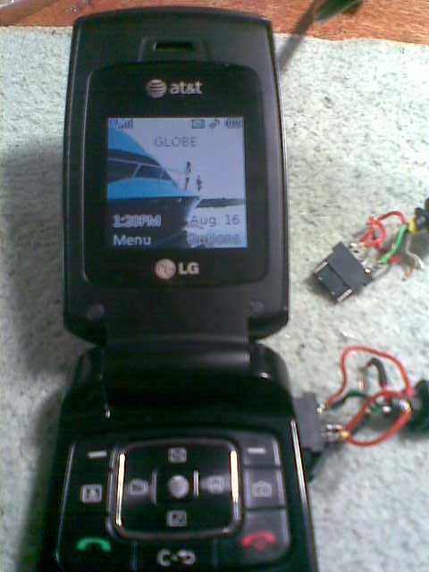

L170 3G Globe locked unlocked using fastmultiloader and Ns Pro
I've been trying to unlock this unit via flashing patch unlock file with Ns Pro but always getting error in flashing Rs1,Rs2 and file sytem.
Finally found solution for writing patch unlock files.:D
Thanks to Master Prolevelz for time spent helping me unlock this unit.
-First change boot using fastmultiloader
-L170 boot files here: http://www.4shared.com/file/60873507/43fc2d29/L170_BOOTFILES.html
-Fast multiloader here: http://www.4shared.com/file/60874989/f8504bfb/FastMultiLoader_V326.html
-open fast multiloader
-tick 6275/6280
-tick boot change
-tick BOOT tab and load your boot files
-use usb cable
-put unit in bootmode press 9+power connect usb cable
-wait till finish installing phone drivers
-tick port search to detect your unit
-once port is detected tick download tab
-after boot files are downloaded
-disconnect cable
 -load L170 Ns Pro patch files for unlock
-connect phone to cable press * phone will go to download mode
-tick port search once unit is detected tick download tab
-wait for downloading to finish
-after successfull download disconnect cable then wait for phone to finish formatting
-open Ns Pro
-select L170 phone model
-power on unit connect to cable
-tick unlock tab

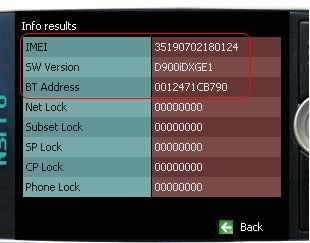

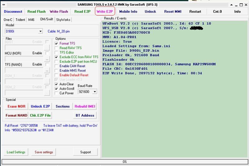

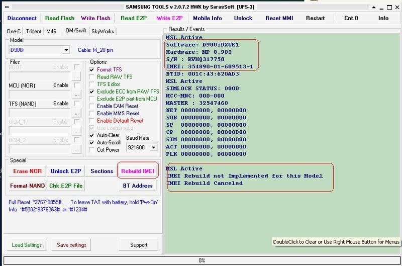

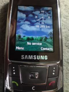

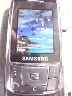

HWK / D900i "no service" write full E2P repair done
« on: August 27, 2008, 05:38:50 AM »
I have been trying to write eeprom file using NsPro with this unit but always error in writing. So I decided to check eeprom file for this unit is availble in Ufs Hwk support Site. Luckily it was. So downloaded the file and write it to unit. Problem Fixed:D
Tried rebuilding original imei but not yet supported with Ufs hwk Samsung. But unit has signal which is all that matters. :)
Read info using NsPro
E2P flashing Ufs hwk:
-I used D800 rj45 cable from NsPro
-Tick write E2P tab ,load D900i E2P file and wait for flashing finishes
Read info after flashing E2P file unit has new imei:
Before and after:
Here's D900i Full E2P file I used:
http://www.mediafire.com/?byhmolqmdne
B.r.

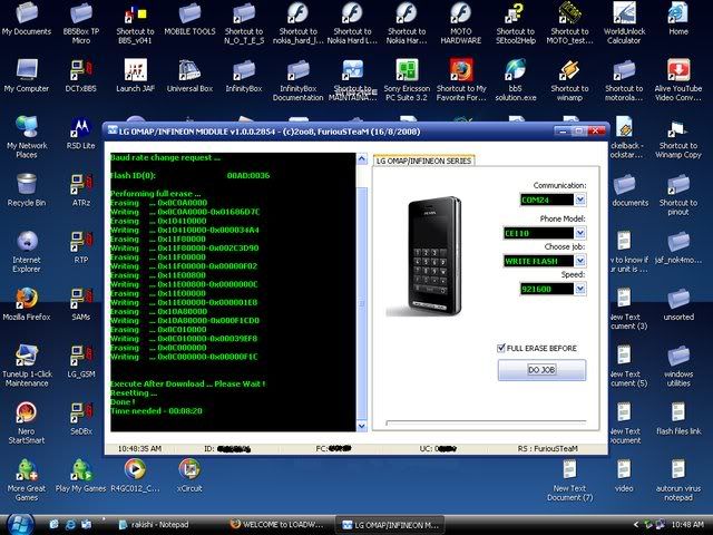

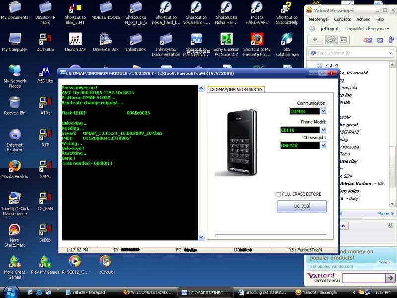

FuriouS TeaM Products / LG CE110 at&t unlock done
« on: August 21, 2008, 06:39:35 AM »
For Ce110 you need to modify KG 800 FG cable to the following :
original pinouts:
****************MG160,KG270,KG370,KG320,KG800 pinout******************************
keyboard up
18.............1
7 - RX (data to phone)
6 - TX (data from phone)
1,4,14,18 - GND
CE110
18.............1
17 - RX (data to phone)
16 - TX (data from phone)
1,4,14,18 - GND
Flash unit with either one of this flash files from support:
CE110P64FL-01-V10g-310-170 JUL 31 2007.zip
CE110P64FL-01-V10i-310-170 JAN 30 2008.zip
After flashing unlock unit
screenshots:
flashing:
unlock:
