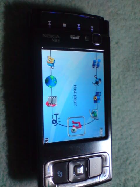

infinity logs:
[COLOR=Lime]Format complete[/COLOR]
WARNING ! Settings will be cleared, user data erased, Imei set to default value !
Make flash backup before this procedure !
Do you want to continue ?
COM1 [Serial0] selected
Device: Autodetect 6205-6227 NOR
Checking data, wait...
advanced flash detection enabled
eeprom backup enabled, it may takes several minutes !
Action: reset
Boot...
Press and HOLD Power button now !
19200 fixed
Connecting, wait...
Initializing[6226:8A02:8A01]...
CPU: MT6226
high speed boot disabled
chip: 0031:318C:3DD8
high speed disabled
boot step size: 0002
Release Power button now !
Boot Done
Initialize...
detecting chip #00 in region #00...
flash: EC257E25082501:2CEA0000000000
flash: Samsung AMD/Fujitsu std [D 0008x002000 00FEx010000 0008x002000] 16Mb
detecting chip #01 in region #00...
number of flash chip/regions detected: 02/01
Initialize Done
Set baud...
115200
Set baud Done
Initialize bootcode...
Initialize bootcode Done
Check firmware integrity...
device parameters autodetection in progress..
it's time to stop: 2C0000EA18F09FE518F09FE518F09FE518F09FE518F09FE5
number of flash chip/regions detected: 01/01
total flash region size: 01000000
detect device identification#1...
detection phase #1...
detect device identification#1 finished
identification#1 structure: 2nd [enhanced] generation
security area#1 is Ok
security area#1 backup saved: C:\Program Files\InfinityBox\ChineseMiracle\backup_security\id.AB23C7C8.[N95_PCB01_GPRS_MT6226_S01.MAUI_06B_W07_04_MP_V32.BIN_D6ADFD7F].rpl
identification#1 detection finished
device-id: AB23C7C8
identification#1 protocol ver: 04
ver. sw1: N95_PCB01_GPRS_MT6226_S01.MAUI_06B_W07_04_MP_V32.BIN
ver. sw2: MAUI.06B.W07.04.MP.V32, 80025229
ffs offset/size: 00E00000/00200000
detect device identification#2...
warning: optional information not found,
if phone works well just ignore this warning
detect device identification#2 finished
detecting eeprom/ffs area in 1 chip(s)...
standard eeprom/ffs offset detected: 00E00000
checking area[00000000]: 00000000-00FFFFFF...
eeprom/ffs found near: 00E00000
detecting eeprom/ffs size...
eeprom/ffs size: 00200000
ffs chip: 00
eeprom/ffs area: 00000000:00E00000-00FFFFFF
Check firmware integrity Done
Check firmware content...
Check firmware content Done
Backup required data...
reading [eeprom[N95_PCB01_GPRS_MT6226_S01.MAUI_06B_W07_04_MP_V32.BIN]]...
file saved: C:\Program Files\InfinityBox\ChineseMiracle\eeprom[N95_PCB01_GPRS_MT6226_S01.MAUI_06B_W07_04_MP_V32.BIN]_20080724-162230.B0E.bin
Backup required data Done
Patch required data...
Patch required data Done
Special operation...
Special operation Done
Write...
Write Done
Finalization...
formatting...
Finalization Done
file saved: C:\Program Files\InfinityBox\ChineseMiracle\system_log_AB23C7C8_N95_PCB01_GPRS_MT6226_S01.MAUI_06B_W07_04_MP_V32.BIN_D6ADFD7F_20080724-162249.B0X.bin
Finished, time used: 249 sec
Remove/Install battery now !
File system has been modified !
It is need to press and HOLD phone "Power" button
during long time (up to 1 min) to make phone Powered-On !
[COLOR=Lime]Phone info:[/COLOR]
Action: read information
Model: Autodetect 6205-6227 NOR
Phone should be Switched ON !
Connecting, wait...
Phone detected, wait...
Hardware version: MT6226, E02
Hardware version: N95_06B_HW
Software version: MAUI.06B.W07.04.MP.V
Software date: 2005.04.12
Barcode: MT012345678901234567
imei: [COLOR=Lime]135790246811220[/COLOR]
Finished, time used: 5 sec
Power off phone now !
[COLOR=Lime]Rebuild ime[/COLOR]
Action: imei
Connecting, wait...
imei: 135790246811220
imei write method: mode-1
new imei: 357927000015498
imei verified Ok

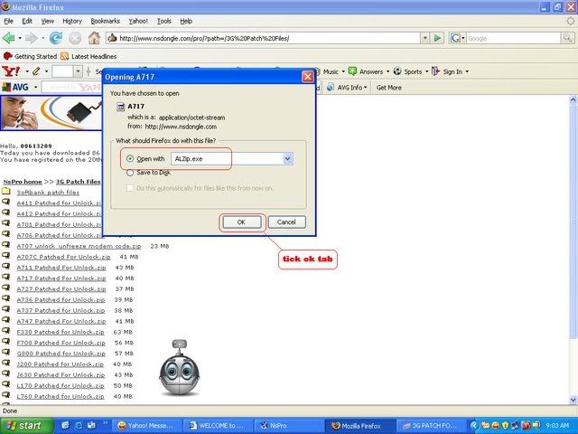

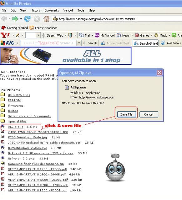

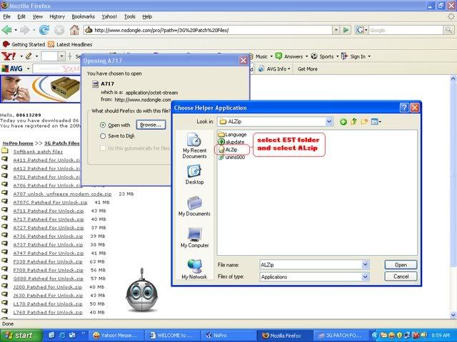

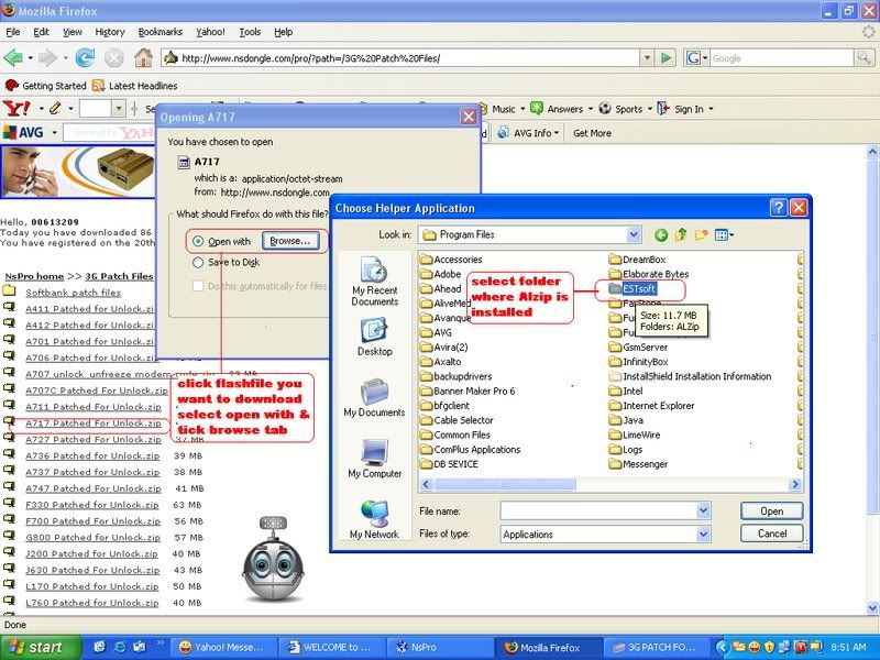

.: .: How to properly download flash files from Ns Pro  support site for newbies :. :.
- 1st need to download ALZip Zip Utility tool
- Open Ns Pro
- Click support tab
- Click,save and download ALZip.exe. And install
- After you have installed ALZip. You're ready to download flash files
- Select ALZip tick open tab
- tick Ok tab

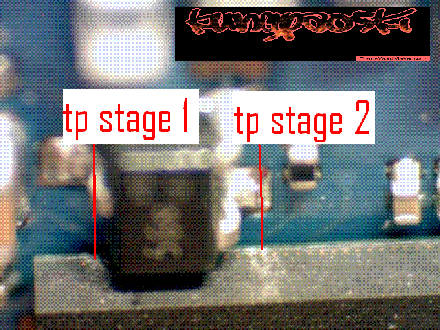

34

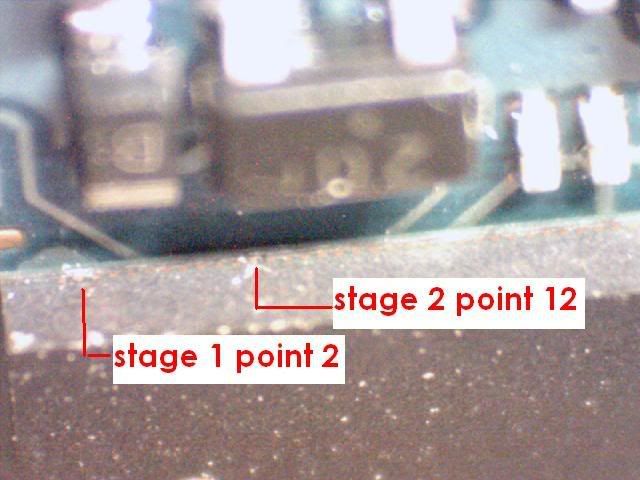

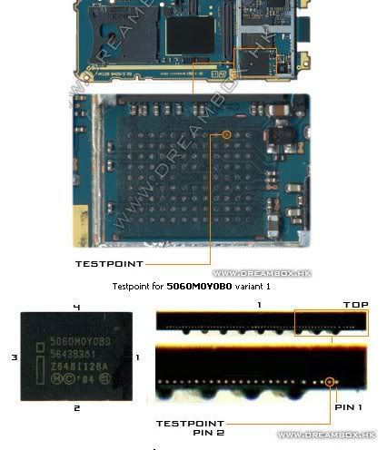

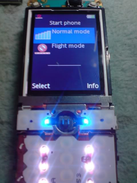

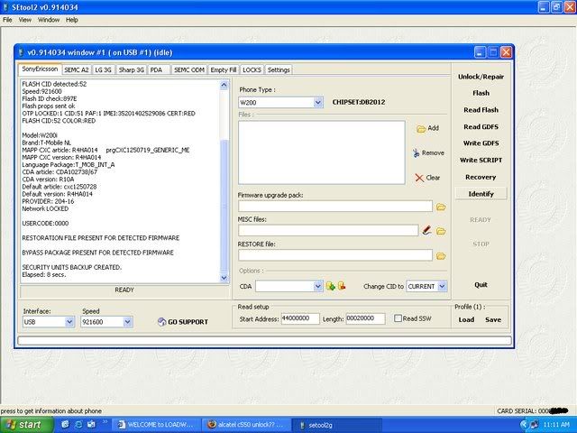

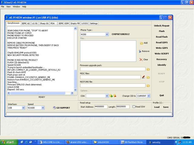

Setool Section / K810 "red blink" repair gdfs done
« on: July 11, 2008, 05:47:58 PM »
7/11/2008 12:06:14 PM v0.914037/UNI
7/11/2008 12:06:14 PM CARD SERIAL: kungpaoski
7/11/2008 12:06:14 PM Loaded 51 flash descriptors
7/11/2008 12:06:14 PM Connecting to UFS...
7/11/2008 12:06:14 PM Found 2 FTDI device(s).
7/11/2008 12:06:15 PM UFS kungpaoski READY
7/11/2008 12:06:18 PM TESTPOINT REPAIR STAGE #1 STARTED
7/11/2008 12:06:19 PM ChipID:9900,EMP protocol:0301
7/11/2008 12:06:19 PM Speed:921600
7/11/2008 12:06:20 PM OTP LOCKED:1 CID:51 PAF:1 IMEI:35799401690563 CERT:N/A
7/11/2008 12:06:20 PM FLASH CID:52 COLOR:RED
7/11/2008 12:06:21 PM LDR:061201 1314 HANCXC1329129_DB2020_FLASHLOADER_R2A005
7/11/2008 12:06:21 PM PREPARING...
7/11/2008 12:06:27 PM ATTACH TP #1 AND PRESS "READY"
7/11/2008 12:06:59 PM RELEASE TP #1 AND PRESS "READY"
7/11/2008 12:07:02 PM TP #1 INCORRECT
7/11/2008 12:07:02 PM Elapsed: 44 secs.
7/11/2008 12:07:04 PM TESTPOINT REPAIR STAGE #1 STARTED
7/11/2008 12:07:06 PM ChipID:9900,EMP protocol:0301
7/11/2008 12:07:06 PM Speed:921600
7/11/2008 12:07:06 PM OTP LOCKED:1 CID:51 PAF:1 IMEI:35799401690563 CERT:N/A
7/11/2008 12:07:06 PM FLASH CID:52 COLOR:RED
7/11/2008 12:07:07 PM LDR:061201 1314 HANCXC1329129_DB2020_FLASHLOADER_R2A005
7/11/2008 12:07:07 PM PREPARING...
7/11/2008 12:07:14 PM ATTACH TP #1 AND PRESS "READY"
7/11/2008 12:07:35 PM RELEASE TP #1 AND PRESS "READY"
7/11/2008 12:07:37 PM TP #1 LOOKS OKAY
7/11/2008 12:07:46 PM DONE
7/11/2008 12:07:46 PM TESTPOINT REPAIR STAGE #2 STARTED
7/11/2008 12:07:48 PM ATTACH TP #2 AND PRESS "READY"
7/11/2008 12:08:09 PM Trying to launch embedded bootloader...
7/11/2008 12:08:09 PM TP #2 LOOKS OKAY
7/11/2008 12:08:09 PM RELEASE TP #2 AND PRESS "READY"
7/11/2008 12:08:14 PM INT LDR:DB2020_PRELOADER_FOR_SETOOL2
7/11/2008 12:08:17 PM WRITING EROM...
7/11/2008 12:08:20 PM DONE
7/11/2008 12:08:21 PM Elapsed: 76 secs.
7/11/2008 12:09:32 PM ChipID:9900,EMP protocol:0301
7/11/2008 12:09:32 PM Speed:921600
7/11/2008 12:09:33 PM OTP LOCKED:1 CID:51 PAF:1 IMEI:35799401690563 CERT:N/A
7/11/2008 12:09:33 PM FLASH CID:49 COLOR:BROWN
7/11/2008 12:09:35 PM LDR:060721 1021 DB2020_SERVICE_LOADER
7/11/2008 12:09:35 PM Flash ID check:897E
7/11/2008 12:09:35 PM Flash props sent ok
7/11/2008 12:09:35 PM writing D:\setool flashes\v0.914037\gdfs_in_ssw_format\db2020\K800_GDFS_SSW.ssw
7/11/2008 12:09:37 PM CURRENT FLASH FILE CID:49
7/11/2008 12:09:37 PM SSW uses complete hash, hash len is:640
7/11/2008 12:09:37 PM Will flash 32 blocks...
7/11/2008 12:10:11 PM SSW loading returns:0
7/11/2008 12:10:11 PM Setting up GDFS...
7/11/2008 12:10:12 PM OTP WRITE NOT EXECUTED.
7/11/2008 12:10:12 PM Writing simlocks...
7/11/2008 12:10:12 PM ALL UNLOCK/LOCK CODES SET TO "71605041"
7/11/2008 12:10:12 PM Signing...
7/11/2008 12:10:12 PM control keys complete.

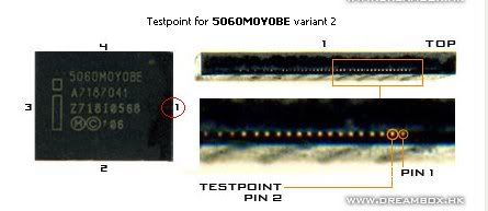

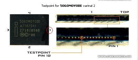

test points
stage 1:
stage 2:

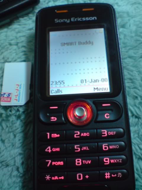

Ngaun lang na post wala ako internet connection kanina :)

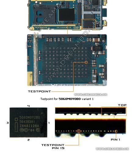

stage 1 tp:
stage 2 tp:

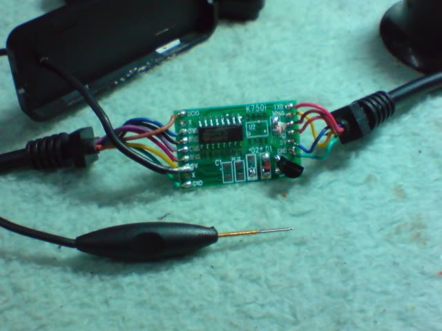

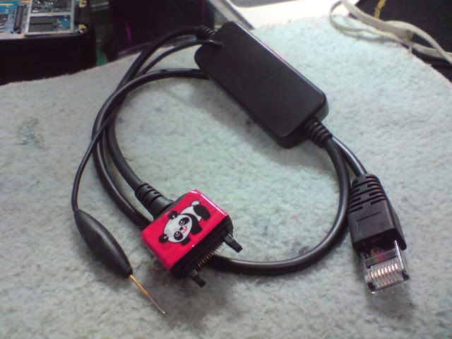

my tp cable from old k750i ufs hwk cable
just soldered tp wire
tp points depend on what flash chip variant unit has to check this go to setool folder/dreambox_tp_info folder/then just click w850_tp_info firefox html.

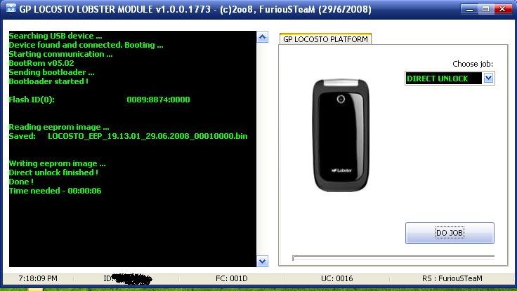

FuriouS TeaM Products / Lobster 320 virgin mobile unlockdone
« on: June 29, 2008, 05:45:14 PM »
cable needed mini-usb cable same as for motorola.
>> UPDATE DONGLE TO MODULE PACK 3 FIRST.
» CONNECT POWERED OFF PHONE TO MINI-USB CABLE AND CONNECT TO PC USB PORT..
» if is first time you connect pc will ask for LOCOSTO DRIVERS. THESE DRIVERS CAN BE FOUND IN MODULE ARCHIVE
» AFTER INSTALING THOSE PRESS CANCEL NEXT ITEM WINDOWS ASK FOR DRIVERS (YOU JUST NEED TO INSTALL LOCOSTO DRIVERS)
» if PC ASK FOR MOTOROLA DRIVERS WHEN INSTALLED USE MOTOROLA DRIVERS UNINSTALKLER FROM MODULE ARCHIVE
>> AFTER YOU HAVE INSTALLED LOCOSTO DRIVERS DISCONNECT PHONE FROM CABLE AND INSERT AGAIN THEN PRESS "DO JOBS" TAB.
For LOCOSTO LOBSTER MODULE you can download from support locosto drivers and motorola uninstaller is also included.

39
Infinity-Box / N95 dual slide restart problem repair done
« on: June 14, 2008, 11:12:24 AM »
Formatt file system

Setool Section / W200 T-mobile Unlock done with test-sim
« on: June 01, 2008, 06:13:27 PM »

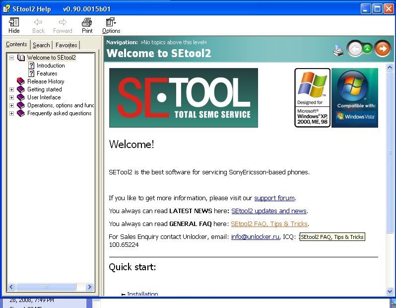

Setool Section / .: Setool2 Help Guide :.
« on: May 29, 2008, 07:48:37 PM »
