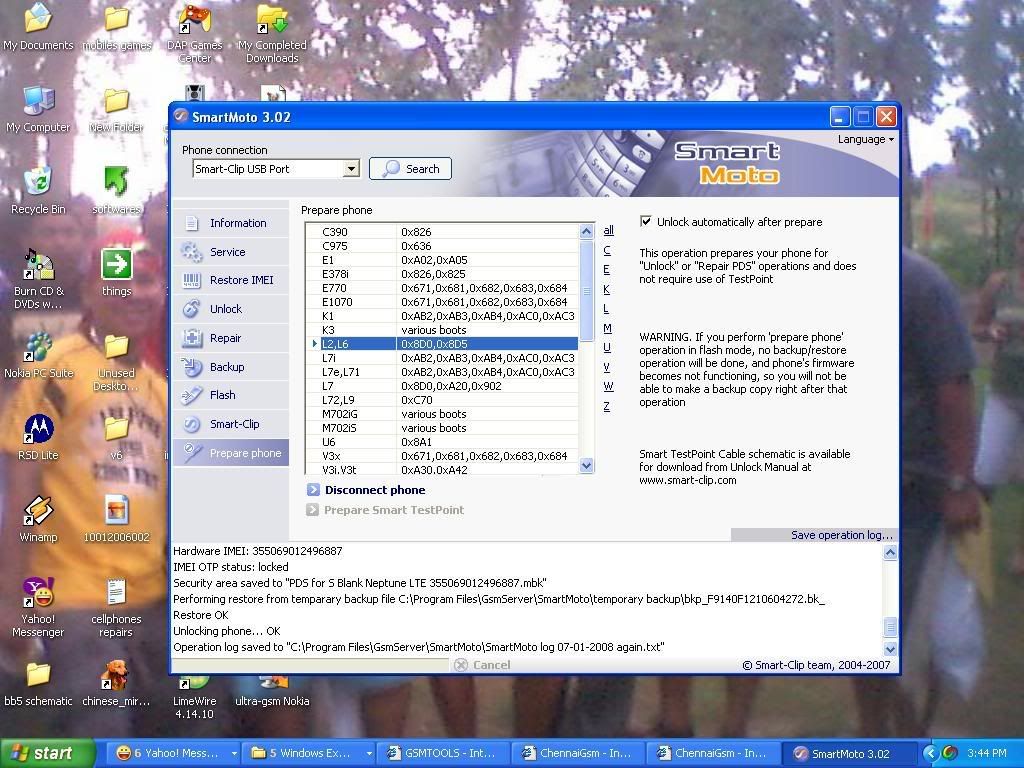

l6 unlocked done via prepare phone
just boot in normal mode then read info then go to prepare phone highlight the l6 model then hit prepare thats all
SmartMoto 3.02
S-Card: raezak Smart-Clip dongle, v 2.01, assigned Smart-Clip: raezak8 Europe, initializing... OK
Clip serial: 86raezak8, version: 4.01, initializing... OK
Searching for phone... found S Blank Neptune LTE, getting test interface... interface not found
Switching to flash mode... OK
Reading phone boot version... 2.00
Boot version 0x200 is not supported for model 'L2,L6'
Searching for phone... found S Flash Neptune LTE, getting test interface... interface not found
Reading phone boot version... 8.D5
Sending boot... OK
Erasing flash memory OK
Sending firmware OK
Reading flash id... ST - M30L0R8000B0
Phone group: A630,E1,E37x,E39x,E55x,L6,U6,V3,V190,V330,V53x,V54 x,V55x,V62x,V635,V80
Hardware IMEI: 355069012496887
IMEI OTP status: locked
Security area saved to "PDS for S Blank Neptune LTE 35raezak6887.mbk"
Performing restore from temparary backup file C:\Program Files\GsmServer\SmartMoto\temporary backup\bkp_F9140F1210604272.bk_
Restore OK
Unlocking phone... OK
