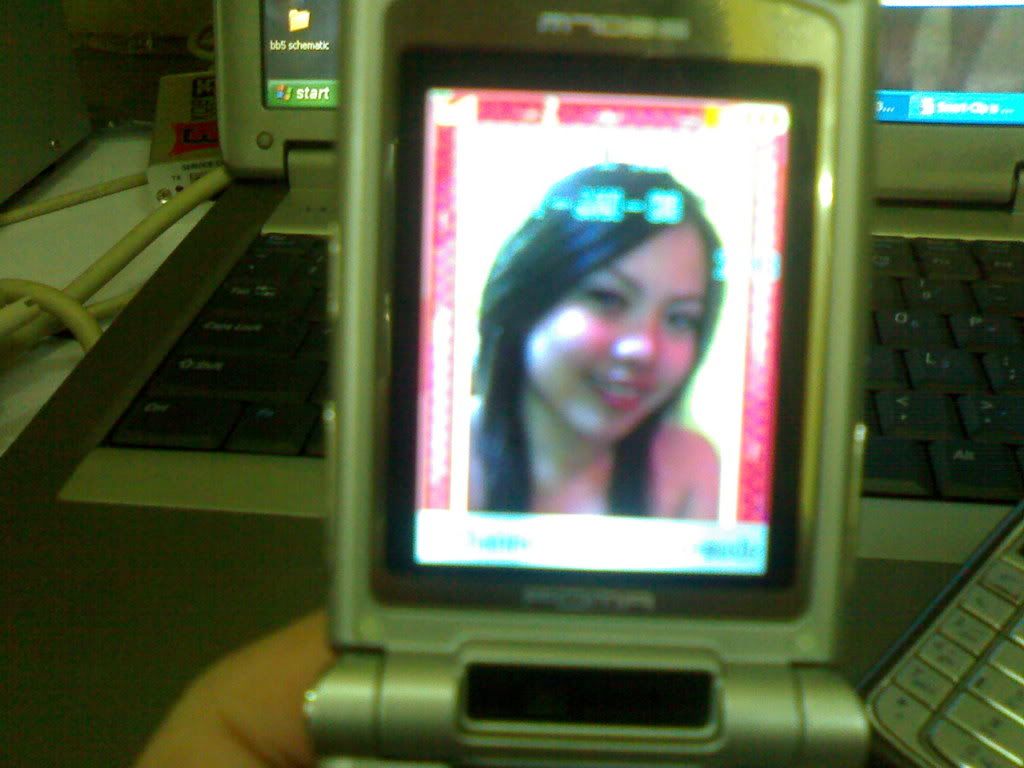

m702is foma succesfully revived and unlocked
« on: January 07, 2008, 12:15:18 PM »

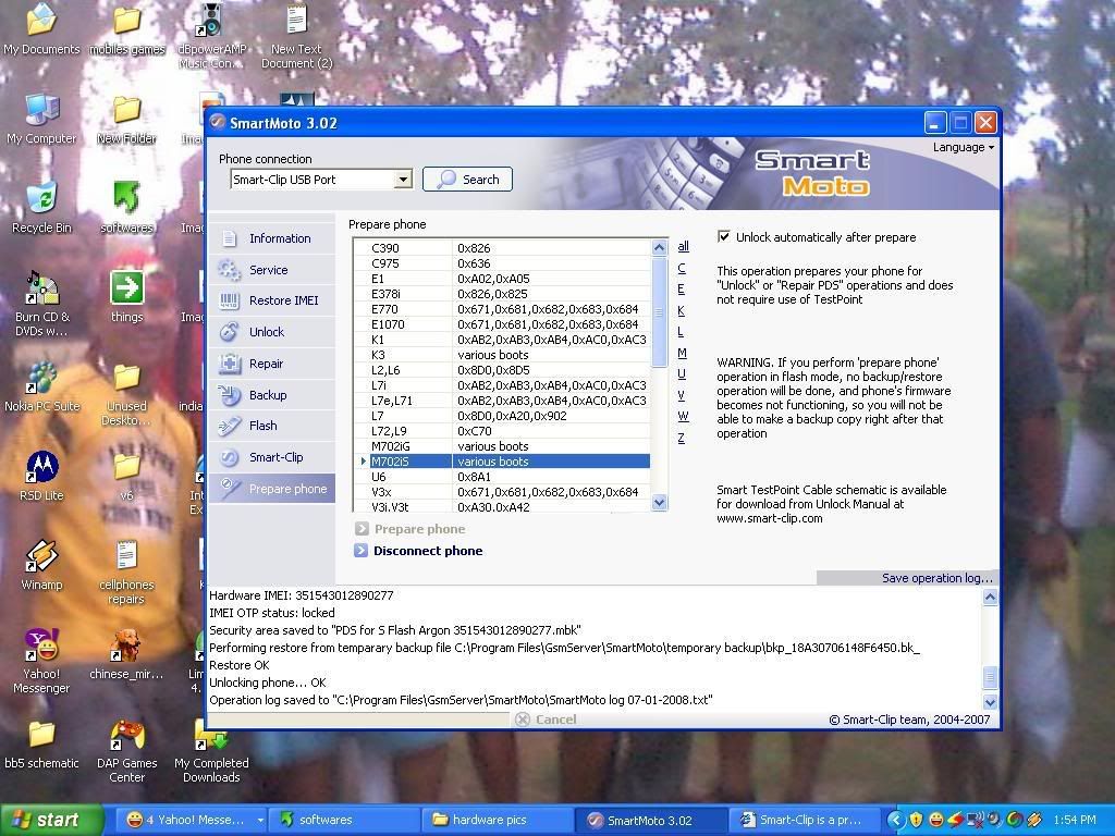

after unlock failed phone turn to bootloader only im confused why it always show communication failed but most important is bkp back up no need to fullflash just start procedure again prepare smart tp then follow the instruction ...
thanks to sir shaw and kungpaoski for the guide and to my brother smart tp tested 100%
SmartMoto 3.02
S-Card: 9raezak17 Smart-Clip dongle, v 2.01, assigned Smart-Clip: 8raezak28 Europe, initializing... OK
Clip serial: 8raezak8, version: 4.01, initializing... OK
Searching for phone... found S Flash Argon, getting test interface... interface not found
Switching to flash mode... OK
Reading phone boot version... 3.03
Sending boot... OK
Processing data, 6 of 6 block...OK
Erasing flash memory OK
Sending firmware OK
Reading phone boot version... 0.00
Reading flash id... AMD - S71WS512NE0
Reading flash id/2... AMD - S71WS512NE0, OK
Phone group: K3,M702iG,M702iS,V1100,V3xx,V6,V9
Hardware IMEI: 351543012890277
IMEI OTP status: locked
Security area saved to "PDS for S Flash Argon 3515raezak277.mbk"
Performing restore from temparary backup file C:\Program Files\GsmServer\SmartMoto\temporary backup\bkp_18A30706148F6450.bk_
Restore OK
Unlocking phone... OK
