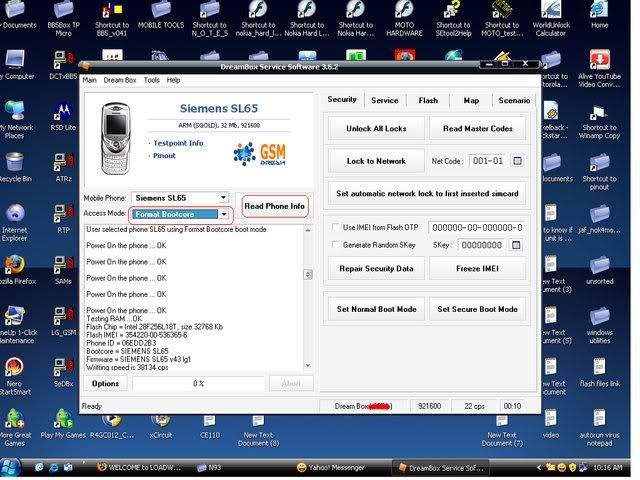

Siemens SL65 phone code problem repair done
-read info using format bootcore access mode (1st tried via normal acces mode cannot read phone info)

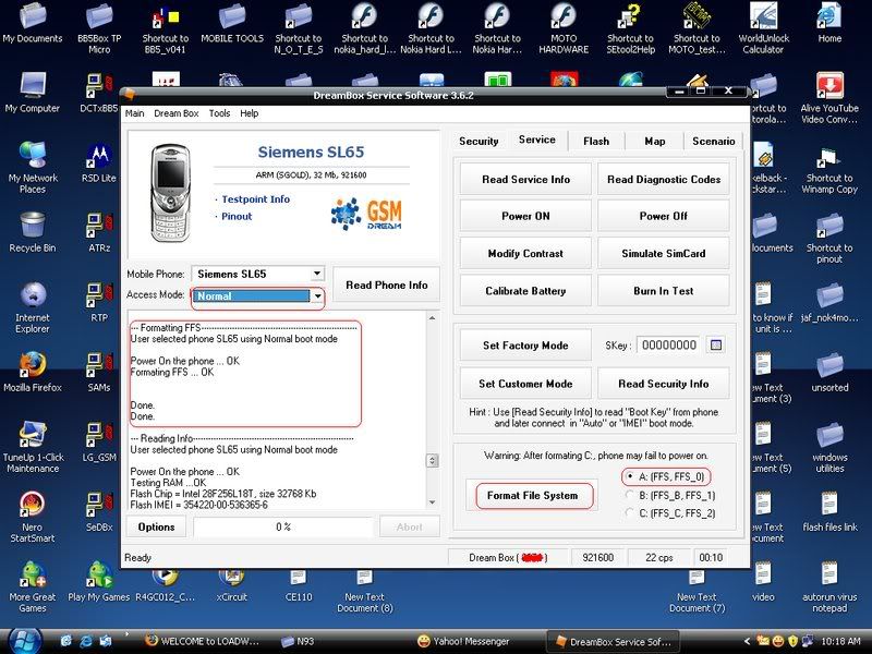

-Tried format file system A:(FFS,FFS_01) DBSS service tab but still phone code problem

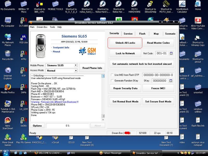

-So tried to unlock all locks in DBSS Security Tab. That did it!!!!!!!

User selected phone SL65 using Format Bootcore boot mode
Power On the phone ... OK
Testing RAM ...OK
Flash Chip = Intel 28F256L18T, size 32768 Kb
Flash IMEI = 354220-00-536365-6
Phone ID = 06EDD2B3
Bootcore = SIEMENS SL65
Firmware = SIEMENS SL65 v43 lg1
Writting speed is 38134 cps
Phone IMEI = 354220-00-536365-6
SPLock CRC = OK
Phone Code = 2918 : FE
SIMCardID = 113107
Done.

--- Formatting FFS-------------------------------------------------------------
User selected phone SL65 using Normal boot mode
Formating FFS ... OK
Done.
Done.

--- Unlocking------------------------------------------------------------------
Testing RAM ...OK
Phone ID = 06EDD2B3
Bootcore = < NOT SET >  SL65
Warning : Firmware info different from Bootcore.!!!
SPLock CRC = OK
Writting speed is 134 cps
Done.
