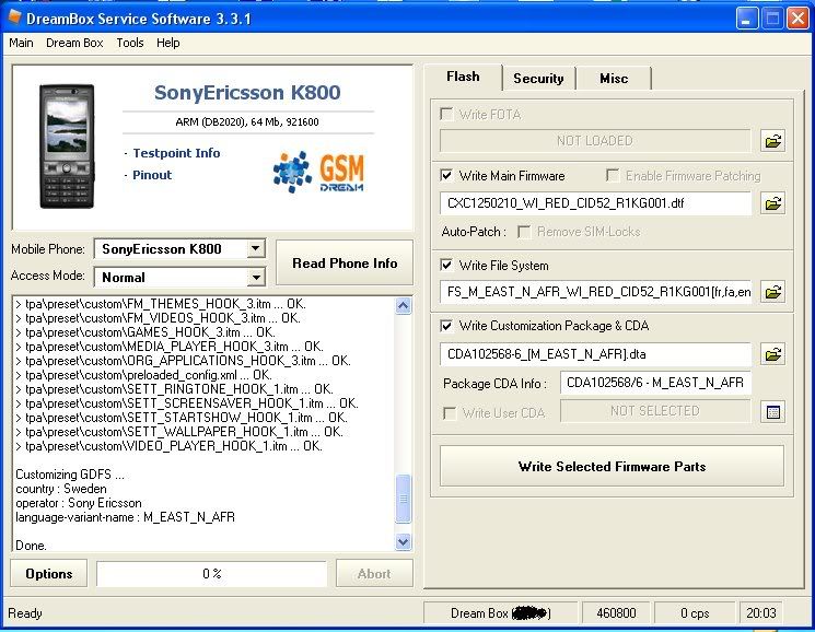

-- Writing firmware-----------------------------------------------------------
User selected phone K800 using Normal boot mode
1) Turn OFF the phone.
2) Connect the phone to DreamBox cable.
Boot Responce = 5A
Processor ID = 99000301FFFFFFFF (DB2020 / DB2030)
NOR Flash ID = 897E
OTP Status = LOCKED
OTP IMEI = 353996-01-53744:)
OTP CID = 49
EROM Color = 4 : RED
EROM CID = 52
Sending Main Firmware Certificate ... OK.
Writing Main Firmware Blocks Finished.
Sending File System Certificate ... OK.
Writing File System Blocks Finished.
Starting CS Loader GDFS Service ...
Starting CS Loader File System Service ...
Uploading files:
> tpa\preset\custom\CONTENT_DOWNLOAD_HOOK.itm ... OK.
> tpa\preset\custom\Customize.xml ... OK.
> tpa\preset\custom\FM_PICTURES_HOOK_3.itm ... OK.
> tpa\preset\custom\FM_SOUNDS_HOOK_3.itm ... OK.
> tpa\preset\custom\FM_THEMES_HOOK_3.itm ... OK.
> tpa\preset\custom\FM_VIDEOS_HOOK_3.itm ... OK.
> tpa\preset\custom\GAMES_HOOK_3.itm ... OK.
> tpa\preset\custom\MEDIA_PLAYER_HOOK_3.itm ... OK.
> tpa\preset\custom\ORG_APPLICATIONS_HOOK_3.itm ... OK.
> tpa\preset\custom\preloaded_config.xml ... OK.
> tpa\preset\custom\SETT_RINGTONE_HOOK_1.itm ... OK.
> tpa\preset\custom\SETT_SCREENSAVER_HOOK_1.itm ... OK.
> tpa\preset\custom\SETT_STARTSHOW_HOOK_1.itm ... OK.
> tpa\preset\custom\SETT_WALLPAPER_HOOK_1.itm ... OK.
> tpa\preset\custom\VIDEO_PLAYER_HOOK_1.itm ... OK.
Customizing GDFS ...
country : Sweden
operator : Sony Ericsson
language-variant-name : M_EAST_N_AFR
Done.
Phone's original CID is CID49 convert it first to CID52 then flash unit with CID52 flashfiles from DBSS support site.
