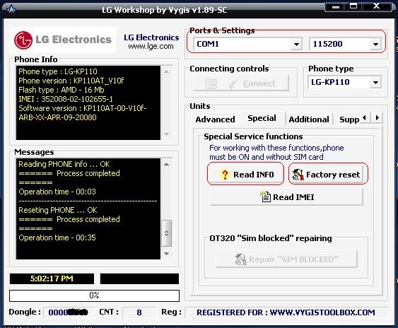

Problem- KP110 cannot open new message menu
Action taken- Reset factory settings using Vygis LG workshop V1.89-sc.
Cable pinouts:
******************KP110,KP115,KP130,KP210,KP215,KP230,KP235 pinout ****************
   keybord up
18.............1
17           - RX (data to phone)
16           - TX (data from phone)
1,4,14,18    - GND
-select com
-power-on unit
-Tick LG workshop V1.89-sc. special tab
-tick read info
-after phone info is read tick factory reset tab
LG KP110 "cannot open new message menu" factory reset done
« on: August 21, 2008, 06:35:32 AM »
« Reply #1 on: August 21, 2008, 06:37:34 AM »
Need Ke 500 cable for this or if you have KG800 fg cable just change rx/tx locations.
