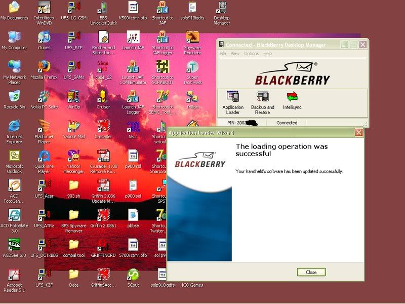

Download Desktop Manager and BB6270 Flash File.
Link: https://www.blackberry.com/Downloads...2B6EA7A23A56D2
NOTE: Phone should be connected Turn-On with no Sim Card.
If model is 5xxx and 6xxx cable to use is Com Cable and the Setting is COM 1.
If model 7xxx and 8xxx Usb Cable setting should be in Usbport.
Step 1: Extract first the Desktop Manager and followed by the BB6720 Flash File.
Step 2: Click Desktop Manager>Options>Set Comport and Follow instruction.
Step 3: You are now connected click Application Loader follow instruction dont forget to click Recommendation need Back-up for safety.
Step 4: Drink coffee and relax.
Step 5: Loading Operation was Successful.
Step 6: Phone now updated.

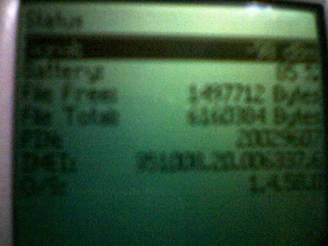

FORMERLY PHONE STATUS IS BELOW:
File Free: 0 Bytes
File Total: 6160384 Bytes
LOOK NOW:
CANNOT RECEIVED TEXT BUT NOW:
