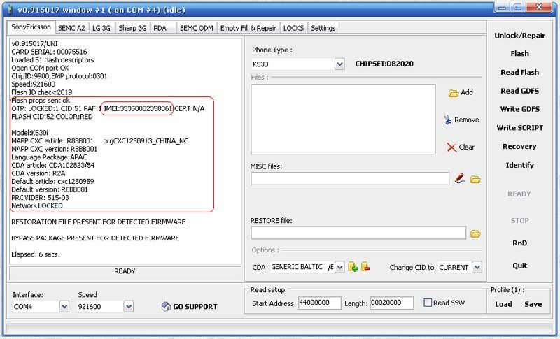

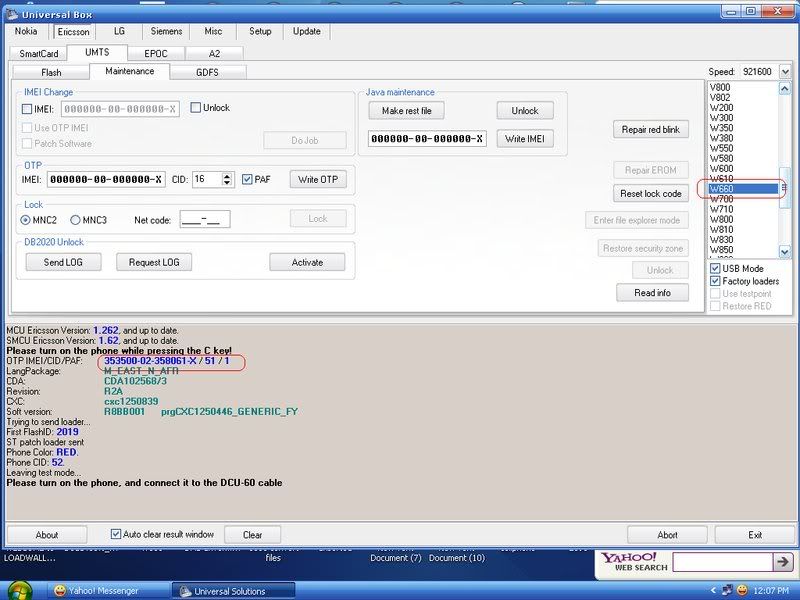

-make GDFSand security back-up first just in case
read info:

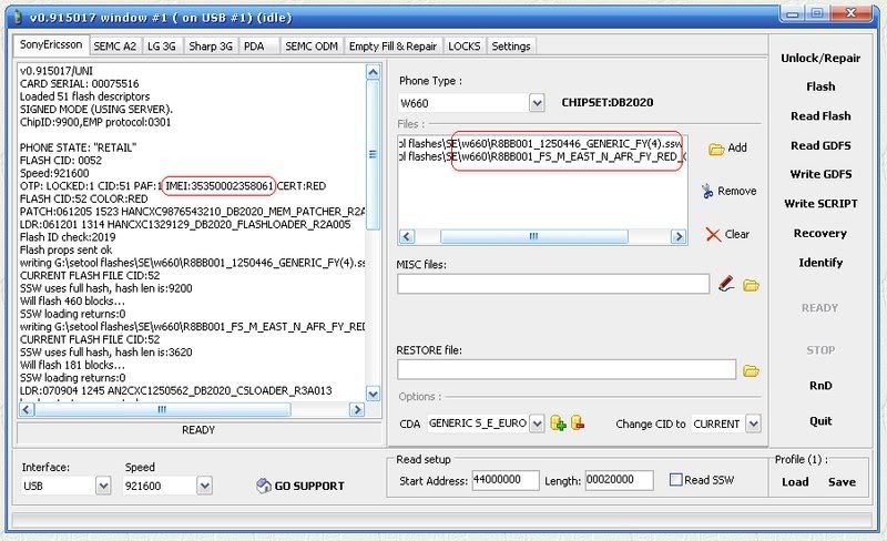

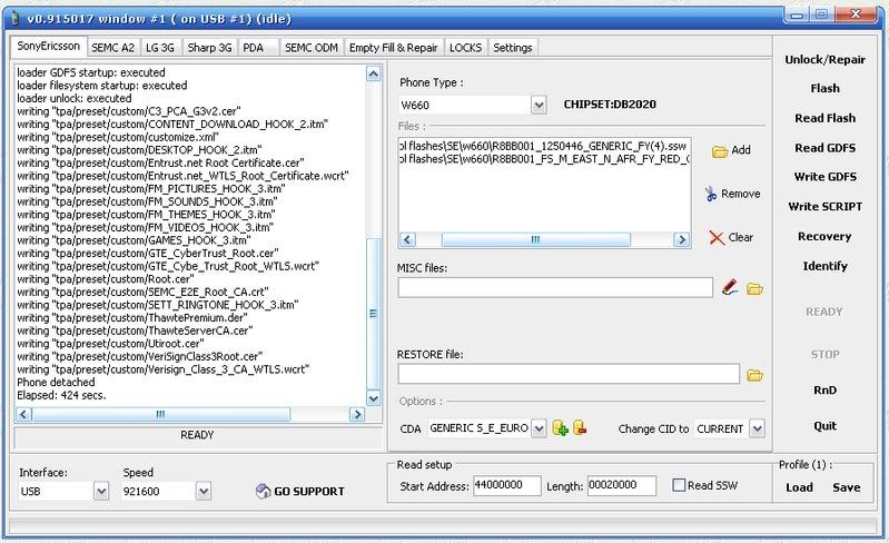

Flash unit with W660 cid 52 fw ( main+fs ) settings put check signmode, complete phone after flash. Use Dcu-60 usb cable for flashing. Flash file must be same cid ver. of unit ( if unit original flash Cid is CID 52 use flash CID 52 flash file )
flashing:
info after flashing:

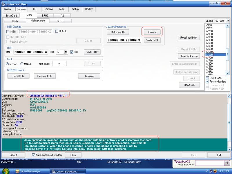

Unit was patch/unlocked before so after flashing unit it is locked again so need to unlock unit again. I used UB box for unlocking. Just select unit and tick unlock tab. And follow instruction after java unlocker is uploaded to unit.

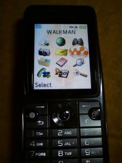

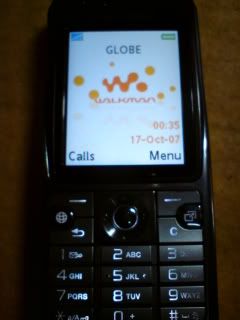

K530i flash convert to W660 using setool then unlocked w/ UB

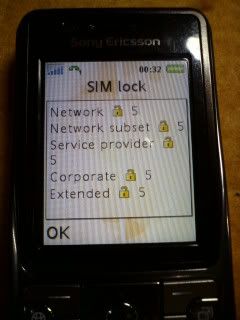

unlock:
After you have run java unlocker application in games menu and phone has restarted. Check sim locks info press >*<<*<* on navigation key.
All locks are open
