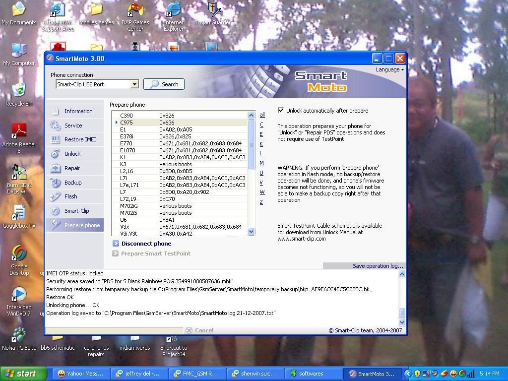

c975 6.3.6 unlocked via prepare phone
SmartMoto 3.00
S-Card: 9raezak17 Smart-Clip dongle, v 2.00, assigned Smart-Clip: 86raezak8 Europe, initializing... OK
Clip serial: 8raezak28, version: 4.00, initializing... OK
Searching for phone... found Motorola Phone (C975), getting test interface... OK
Model C975
Firmware R245_U_82.21.80I
Switching to flash mode... OK [S Flash Rainbow POG]
Reading phone boot version... 6.36
Sending boot... OK
Performing backup to temporary file
Stored temporary backup to C:\Program Files\GsmServer\SmartMoto\temporary backup\bkp_AF9E6CC4EC5C22EC.bk_
Backup OK
Erasing flash memory OK
Sending firmware OK
Searching for phone... found S Blank Rainbow POG
Reading phone boot version... 3.10
Reading flash id... Micron - MT28F1284W18BET (x2)
Phone group: C975,C980,V980
Hardware IMEI: 35raezak0587636
IMEI OTP status: locked
Security area saved to "PDS for S Blank Rainbow POG 3549raezak587636.mbk"
Performing restore from temparary backup file C:\Program Files\GsmServer\SmartMoto\temporary backup\bkp_AF9E6CC4EC5C22EC.bk_
Restore OK
Unlocking phone... OK

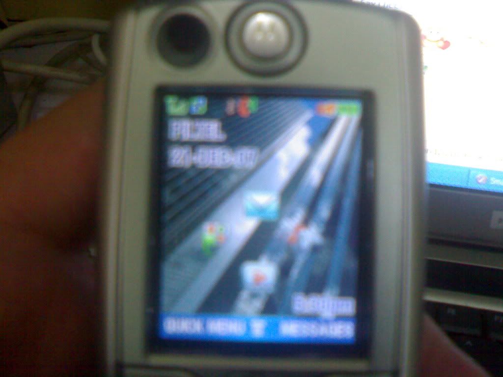

good job my dear sir raezak!!!
well done
