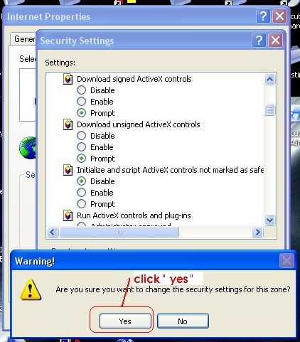

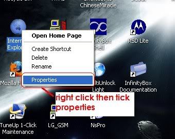

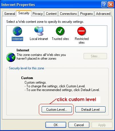

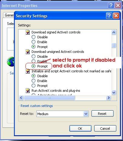

For first time updaters do this first so that Active X control can be installed:

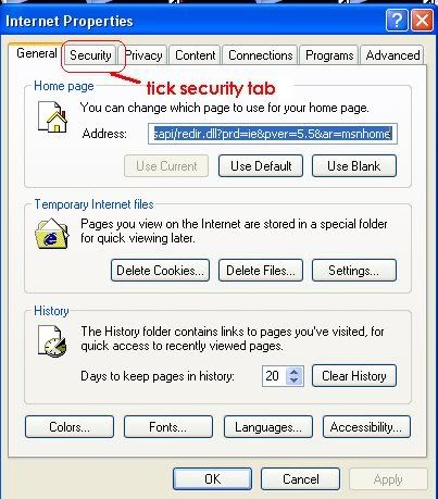

1. Right click on Internet Explorer icon
2. Click properties
3. Click Security tab
4. Click Custom Level tab
5. Scroll down to "Download unsigned Active X control" and select prompt
6. Tick ok then select yes

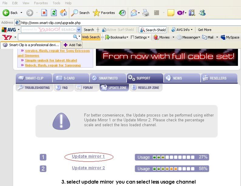

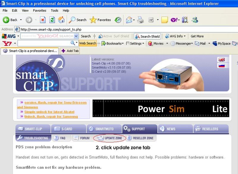

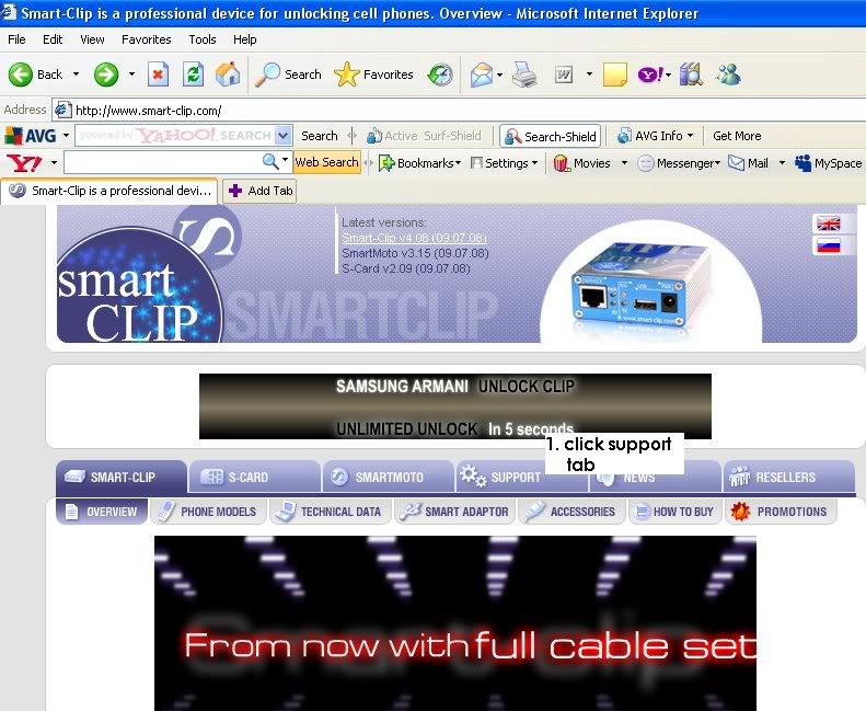

7. now go here
http://www.smart-clip.com/
TICK SUPPORT TAB
TICK UPDATE ZONE
NOW SELECT UPDATE MIRROR ( YOU CAN SELECT MIRROR HAVING LESS USAGE)
NOW IF YOU GET THIS POP-UP BLOCKER JUST CLICK AND INSTALL ACTIVE X CONTROL

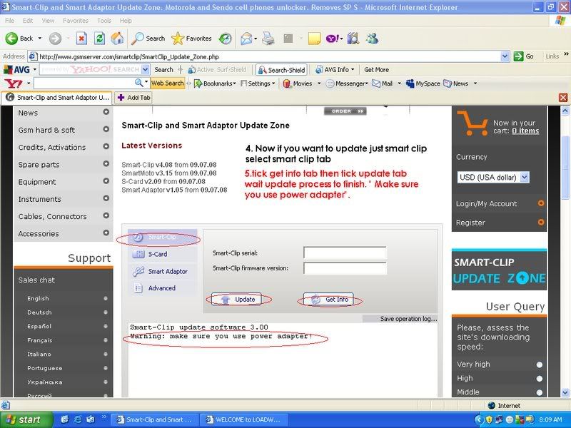

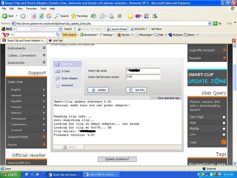

NOW AFTER ACTIVE X CONTROL IS INSTALLED NEW WINDOW APPEARS
IN THIS WINDOW YOU CAN NOW UPDATE YOUR SMART CLIP, S-CARD AND SMART ADAPTOR
NOW CONNECT SMART CLIP TO PC LPT CABLE OR IF YOU ARE USING SMART ADAPTOR UPDATE FIRST SMART ADAPTOR IF NEW UPDATE IS AVAILABLE BEFORE UPDATING SMART CLIP.
AND MAKE SURE YOU USE POWER SUPPLY AND YOUR INTERNET CONNECTION IS STABLE
CONNECT S-CARD TO PC USB PORT.

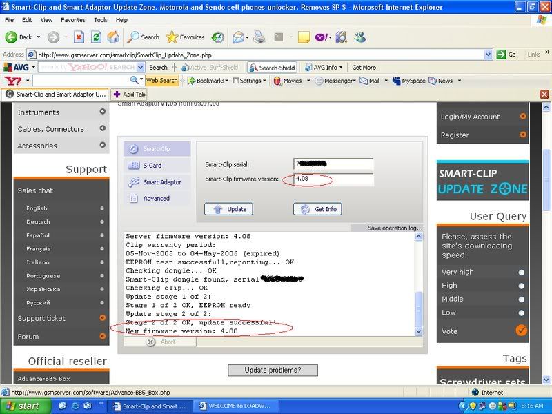

SMART CLIP
-SELECT SMART CLIP TAB
-TICK GET INFO
-TICK UPDATE TAB
-WAIT UPDATE PROCESS TO FINISH

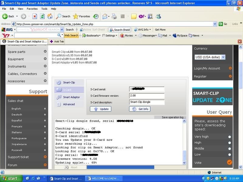

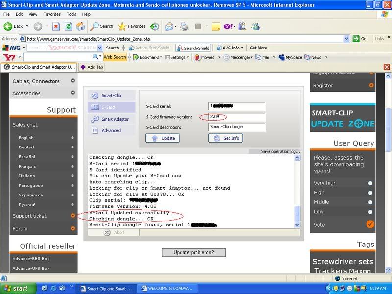

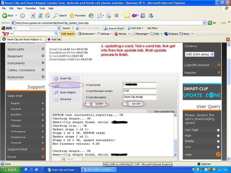

S-CARD
-SELECT S-CARD TAB
-TICK GET INFO
-TICK UPDATE TAB
-WAIT FOR S-CARD UPDATE TO FINISH

SMART CLIP UPDATE
GET INFO
UPDATE SUCCESFULL
S-CARD UPDATE
-INFO
UPDATE PROCESS
UPDATE SUCCESSFUL
