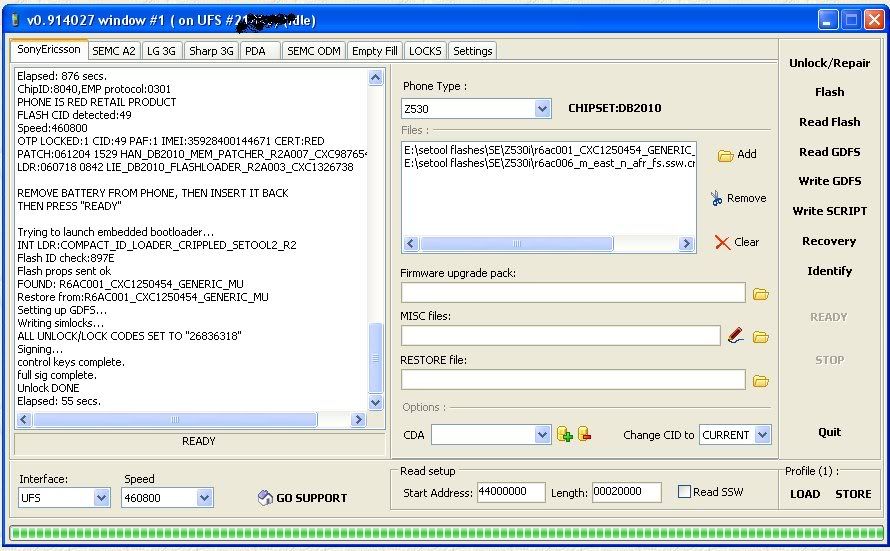

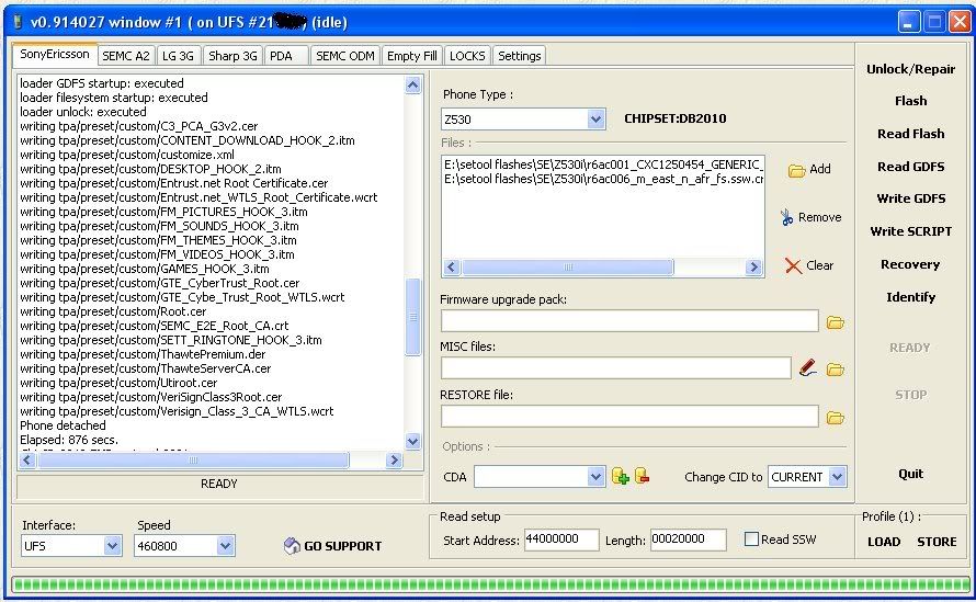

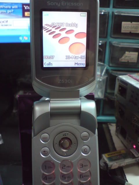

problem : Z530i hang/restart when powered on.
action taken : Tried 1st flashing with setool. But always get this error " Send superblock command NAK ". I used fully charged battery and rps.Tried many times always this same error. For this reheat cpu and flash I.C. Now flashing completed succesfully
error log:
ChipID:8040,EMP protocol:0301
PHONE IS RED RETAIL PRODUCT
FLASH CID detected:49
Speed:460800
OTP LOCKED:1 CID:49 PAF:1 IMEI:35928400144671 CERT:RED
PATCH:061204 1529 HAN_DB2010_MEM_PATCHER_R2A007_CXC9876543210 0
LDR:060718 0842 LIE_DB2010_FLASHLOADER_R2A003_CXC1326738
REMOVE BATTERY FROM PHONE, THEN INSERT IT BACK
THEN PRESS "READY"
Trying to launch embedded bootloader...
INT LDR:COMPACT_ID_LOADER_CRIPPLED_SETOOL2_R2
Flash ID check:897E
Flash props sent ok
FOUND: R6BA030_CXC1250457_HONG_KONG_MU
Restore from:R6BA030_CXC1250457_HONG_KONG_MU
writing E:\setool flashes\SE\Z530i\r6ac001_CXC1250454_GENERIC_MU.ssw .cry
CURRENT FLASH FILE CID:49
SSW uses dynamic hash, dynamic hash len is:328
Will flash 328 blocks...
Elapsed: 327 secs.
Flashing screenshots after reheat of cpu and flash i.c.
