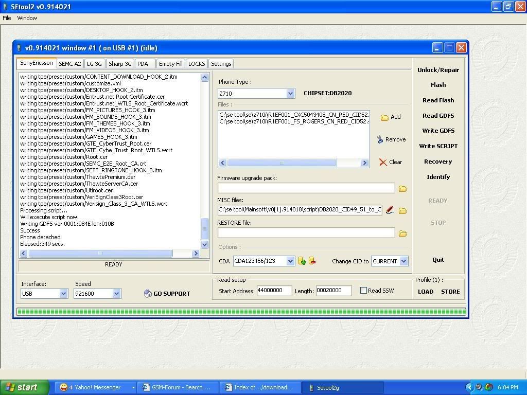

z710 cid 49 upgrade to cid 52 un;locked done
at fisrt i decided to unlock this phone using 1 log but when i looking a restoration file i notice that restoration file is not yet available although i can unlock it by using 1 log again using unlock after flash.... but its much better if its free heheh lolz
here my logs
v0.914021/UNI
CARD SERIAL: 0raezak32
Loaded 51 flash descriptors
Open COM port OK
ChipID:9900,EMP protocol:0301
Speed:921600
Flash ID check:897E
Flash props sent ok
OTP LOCKED:1 CID:49 PAF:1 IMEI:35raezak293 CERT:N/A
FLASH CID:49 COLOR:RED
Model:Z710i
MAPP CXC article: R1EF001 prgCXC1250434_NAM_1_CN
MAPP CXC version: R1EF001
Language Package:ROGERS
CDA article: CDA102651/18
CDA version: R7A
Default article: cxc1250436
Default version: R1EF001
Network LOCKED
Service provider LOCKED
Operator: MULTIPLE
RESTORATION FILE NOT PRESENT
"R1EF001_CXC1250434_NAM_1_CN"
YOU MUST PERFORM FULL FLASHING FOR PATCH UNLOCK
Elapsed:5 secs.

writing C:\se tool\se\z710i\R1EF001_CXC5043408_CN_RED_CID52.ssw
CURRENT FLASH FILE CID:52
SSW uses complete hash, hash len is:9100
Will flash 455 blocks...
SSW loading returns:0
writing C:\se tool\se\z710i\R1EF001_FS_ROGERS_CN_RED_CID52.ssw
SSW uses complete hash, hash len is:2500
Will flash 125 blocks...
LDR:070410 1557 HANCXC1250562_DB2020_CSLOADER_R3A009
loader startup: executed
loader GDFS startup: executed
loader filesystem startup: executed
loader unlock: executed
writing tpa/preset/custom/C3_PCA_G3v2.cer
writing tpa/preset/custom/CONTENT_DOWNLOAD_HOOK_2.itm
writing tpa/preset/custom/customize.xml
writing tpa/preset/custom/DESKTOP_HOOK_2.itm
writing tpa/preset/custom/Entrust.net Root Certificate.cer
writing tpa/preset/custom/Entrust.net_WTLS_Root_Certificate.wcrt
writing tpa/preset/custom/FM_PICTURES_HOOK_3.itm
writing tpa/preset/custom/FM_SOUNDS_HOOK_3.itm
writing tpa/preset/custom/FM_THEMES_HOOK_3.itm
writing tpa/preset/custom/FM_VIDEOS_HOOK_3.itm
writing tpa/preset/custom/GAMES_HOOK_3.itm
writing tpa/preset/custom/GTE_CyberTrust_Root.cer
writing tpa/preset/custom/GTE_Cybe_Trust_Root_WTLS.wcrt
writing tpa/preset/custom/Root.cer
writing tpa/preset/custom/SEMC_E2E_Root_CA.crt
writing tpa/preset/custom/SETT_RINGTONE_HOOK_3.itm
writing tpa/preset/custom/ThawtePremium.der
writing tpa/preset/custom/ThawteServerCA.cer
writing tpa/preset/custom/Utiroot.cer
writing tpa/preset/custom/VeriSignClass3Root.cer
writing tpa/preset/custom/Verisign_Class_3_CA_WTLS.wcrt
Processing script...
Will execute script now.
Writing GDFS var 0001:084E len:010B
Success
Phone detached
Elapsed:349 secs.

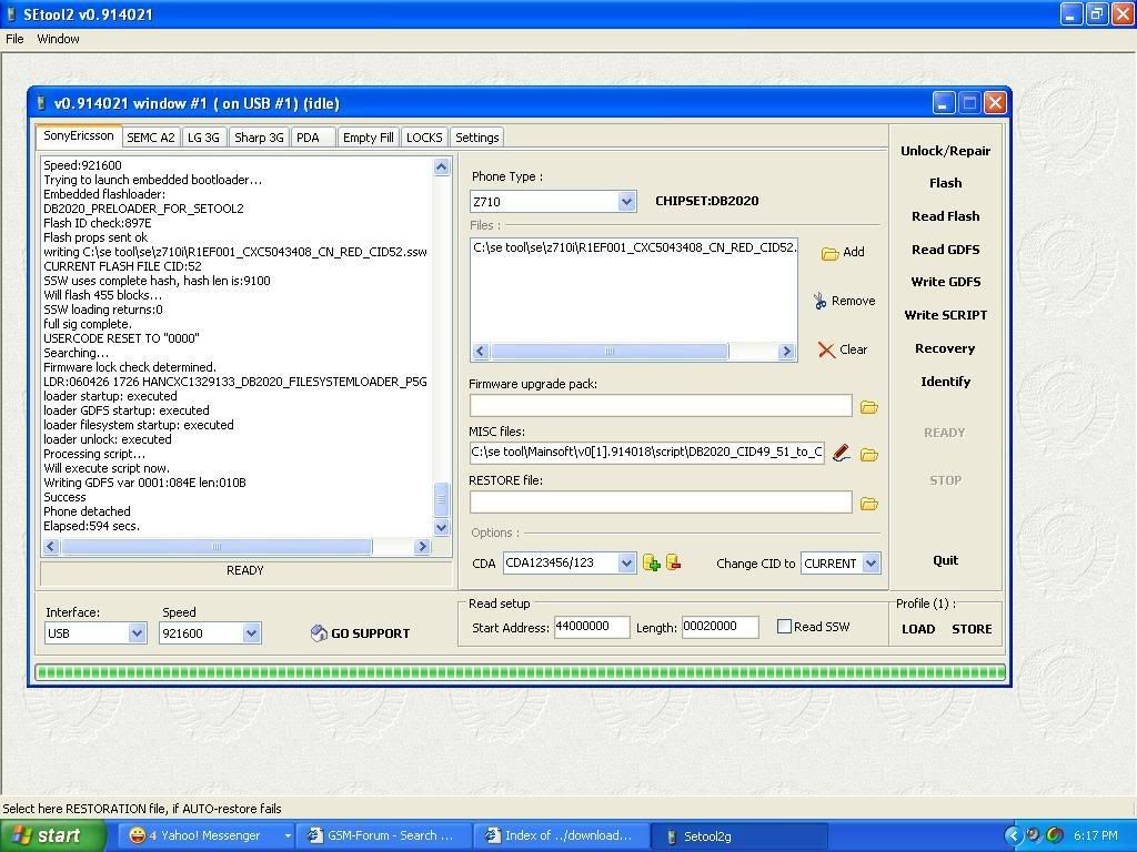

SERVER SUPPORT ENABLED.
ALTERNATIVE SECURITY BYPASS ENABLED.
PHONE IS RED RETAIL PRODUCT
FLASH CID detected:52
Speed:921600
OTP LOCKED:1 CID:49 PAF:1 IMEI:35raezak7293 CERT:RED
FLASH CID:52 COLOR:RED
PATCH:061205 1523 HANCXC9876543210_DB2020_MEM_PATCHER_R2A006 0
LDR:061201 1314 HANCXC1329129_DB2020_FLASHLOADER_R2A005
Flash ID check:897E
Flash props sent ok
CID52 BYPASS PROCEDURE STARTED
Processing part1...
Processing part2...
Processing part3....
OTP LOCKED:1 CID:49 PAF:1 IMEI:354raezak7293 CERT:RED
Flash ID check:897E
Flash props sent ok
REMOVE CABLE FROM PHONE
REMOVE BATTERY FROM PHONE, THEN INSERT IT BACK
THEN PRESS "READY"
HOLD "C" BUTTON AND ATTACH PHONE
CID52 BYPASS PROCEDURE FINISHED
bypassing security...
Speed:921600
Trying to launch embedded bootloader...
Embedded flashloader:
DB2020_PRELOADER_FOR_SETOOL2
Flash ID check:897E
Flash props sent ok
full sig complete.
USERCODE RESET TO "0000"
Searching...
Firmware lock check determined.
LDR:060426 1726 HANCXC1329133_DB2020_FILESYSTEMLOADER_P5G
Success
Phone detached
Elapsed:594 secs.
