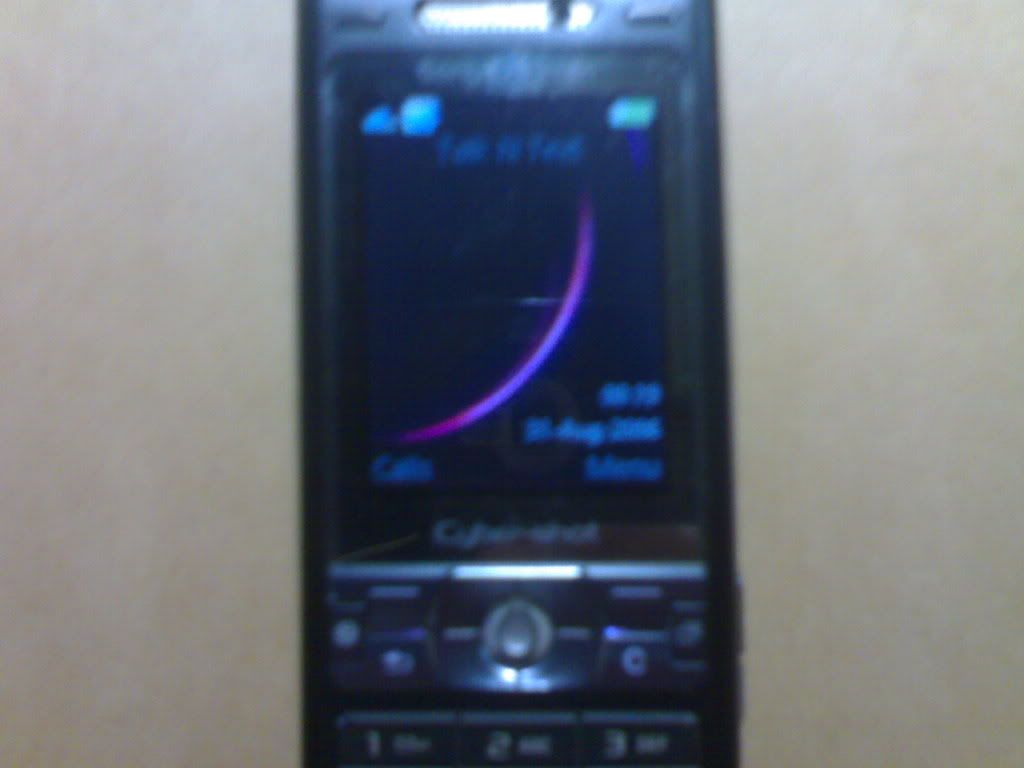

Author Topic: k800i gdfs repaired via testpoint done by setool.  (Read 2385 times)
megatech10
  • Posts: 3
« on: August 19, 2008, 10:22:10 AM »

#after assembling found out its config error
-check complete phone after flash
-flash without flashfiles
