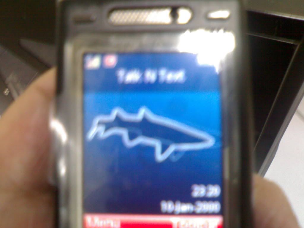

k800 cid 52 unlocked free by se tool
« on: November 24, 2007, 05:23:24 PM »
v0.914014/UNI
Card serial:0raezak
Loaded 51 flash descriptors
SERVER SUPPORT ENABLED.
ALTERNATIVE SECURITY BYPASS ENABLED.
ChipID:9900,EMP protocol:0301
PHONE IS RED RETAIL PRODUCT
FLASH CID detected:52
Speed:921600
Flash ID check:897E
Flash props sent ok
OTP LOCKED:1 CID:51 PAF:1 IMEI:359raezak041963 CERT:RED
FLASH CID:52 COLOR:RED
Model:K800i
MAPP CXC article: R1JC002 prgCXC1250211_VODAFONE_WI
MAPP CXC version: R1JC002
Language Package:VFE_LIVE_2
CDA article: CDA102511/130
CDA version: R1A
Default article: cxc1250490
Default version: R1JC002
Network LOCKED
Operator: 234-15
RESTORATION FILE NOT PRESENT
"R1JC002_CXC1250211_VODAFONE_WI"
YOU MUST PERFORM FULL FLASHING FOR PATCH UNLOCK
SECURITY UNITS BACKUP CREATED.
Elapsed:19 secs.
phone pre-boot failed,possible RECOVERY needed.
Elapsed:9 secs.
Speed:921600
OTP LOCKED:1 CID:51 PAF:1 IMEI:3590raezak1963 CERT:RED
PATCH:061205 1523 HANCXC9876543210_DB2020_MEM_PATCHER_R2A006 0
LDR:061201 1314 HANCXC1329129_DB2020_FLASHLOADER_R2A005
Flash ID check:897E
Flash props sent ok
CID52 BYPASS PROCEDURE STARTED
Processing part1...
Processing part2...
Processing part3....
OTP LOCKED:1 CID:51 PAF:1 IMEI:359raezak63 CERT:RED
Flash ID check:897E
Flash props sent ok
REMOVE CABLE FROM PHONE
REMOVE BATTERY FROM PHONE, THEN INSERT IT BACK
HOLD "C" BUTTON AND ATTACH AGAIN
CID52 BYPASS PROCEDURE FINISHED
Speed:921600
Trying to launch embedded bootloader...
Embedded flashloader:
DB2020_PRELOADER_FOR_SETOOL2
Flash ID check:897E
Flash props sent ok
writing C:\se tool\se\K800\R1JC002_1250211_VODAFONE_WI.ssw
CURRENT FLASH FILE CID:52
SSW uses complete hash, hash len is:9200
Will flash 460 blocks...
SSW loading returns:0
full sig complete.
USERCODE RESET TO "0000"
Searching...
Firmware lock check determined.
Elapsed:584 secs.
