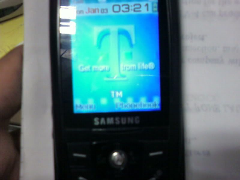

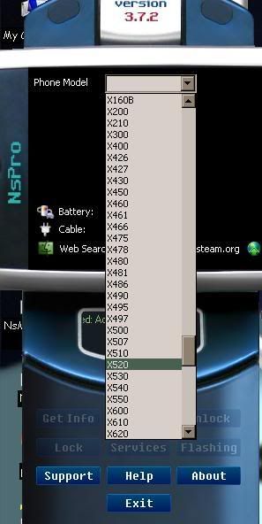

SGH-X566 unlocked via codes
« Reply #2 on: December 11, 2007, 11:15:04 AM »
NS pro did not support this!!!
Lucky i am for the codes!!!
First with different carrier SIM in phone at WRONG CARD screen ENTER on the keypad
*2767*3855# (wait 10-15 seconds) phone will reboot(restart)
Note: if the has its own original sim!!! do not reset anymore with the e2p
go directly at the bottom codes....
When phone completes reboot ENTER
*7465625*638*00000000*00000000#
NEXT ENTER
#7465625*638*00000000#
AND THEN *#7465625# to check the locks....all locks are inactive...these are all the locks...

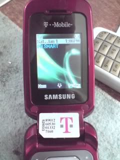

Unlock T229 T-mobile ok 100% via codes
« Reply #9 on: September 16, 2008, 06:13:30 AM »
Insert non T-mobile sim card
You see invalid card
Enter this code
Restart phone
enter this to check lock status
*#7465625#
Restart, phone UNLOCK OK.
