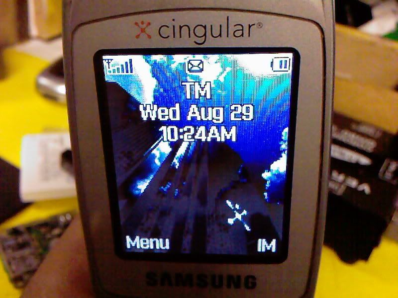

I got no cable with my NS.
So I got this codes!
This code is very common and very usefull!hehehehe.
First with different carrier SIM in phone at WRONG CARD screen ENTER on the keypad
*2767*3855# (wait 10-15 seconds) phone will reboot(restart)
When phone completes reboot ENTER
*7465625*638*00000000*00000000#
NEXT ENTER
#7465625*638*00000000#
AND THEN *#7465625# to check the locks....all locks are inactive...these are all the locks...
network lock - inactive
subset lock - inactive
sp lock - inactive
cp lock - inactive
sim lock - inactive
activa lock - inactive
phone lock - inactive
auto network - inactive
auto subset lock - inactive
auto sp lock - inactive
auto cp lock - inactive
auto sim lock - inactive
just follow this code till you see the Networked Personalized and Network Deactivated!!!
