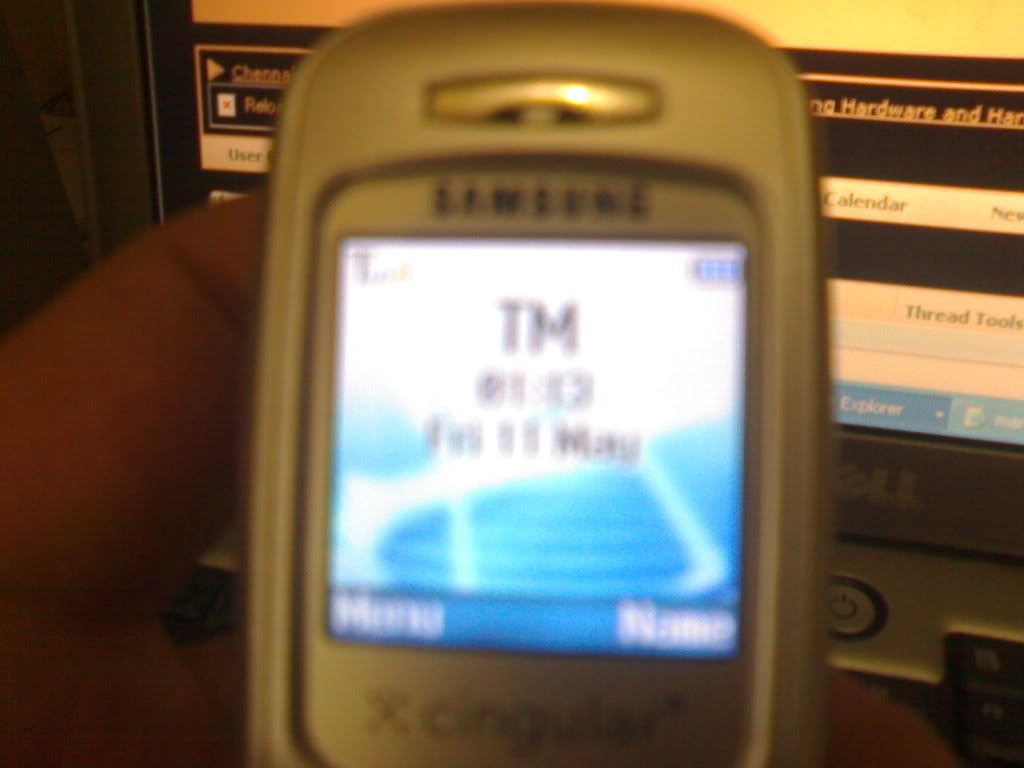

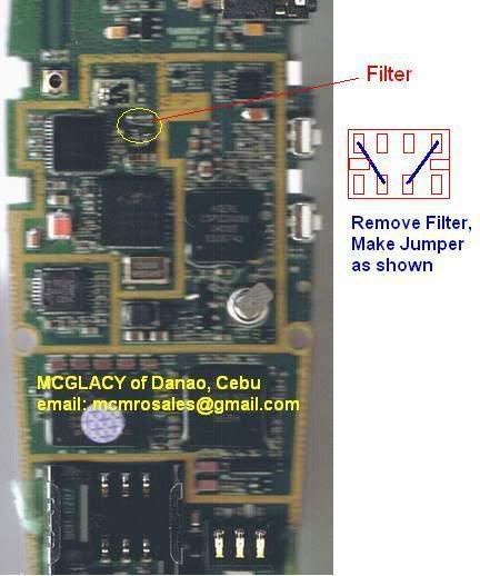

at first you have to flash c207 to c200 firmware using ufs make back uf firmware just in case .. be carefull removing board because of lcd and vibra flex
heres the firmware
http://www.mediafire.com/?44e4hem0twd
thanks to bro kungpaoski for this firmware and method
for modification signal

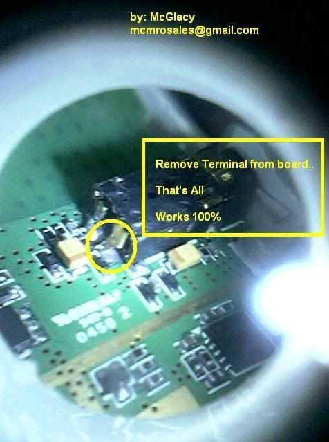

for earpiece remove two teminal from board
and the result
c207 samsung convert to c200 success
