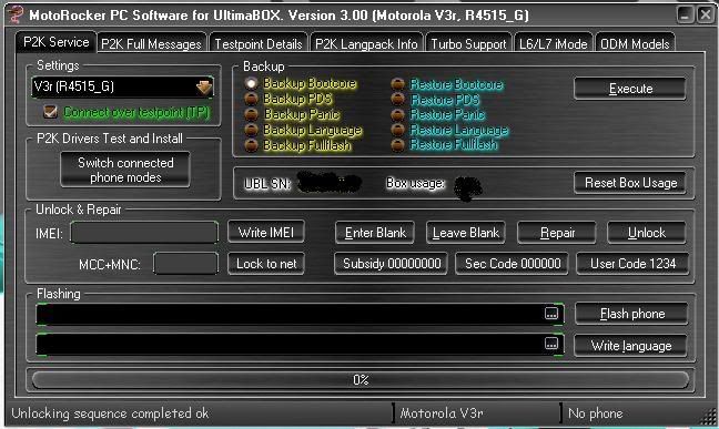

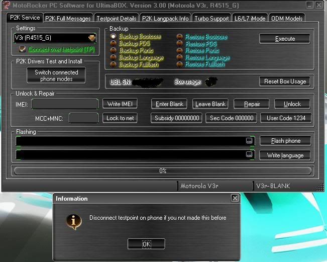

Bootloader
A.52
Sw Version
R4515_G_08.BD.D3R
1sec only in process of sw.

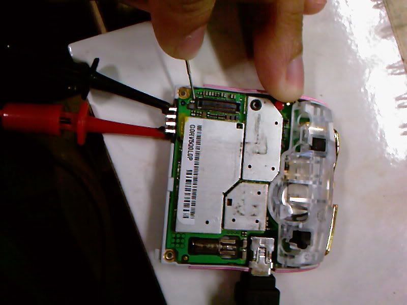

* Do the TP,open SW
* Detect the TP with the SW

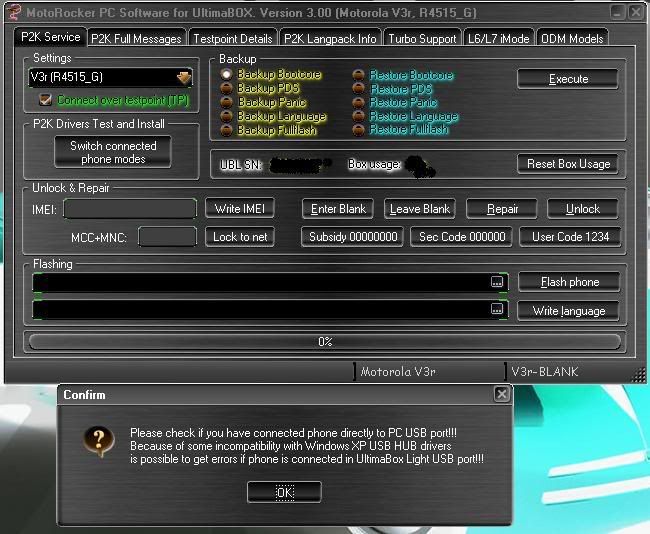

* After detection,check Connect over TP.And tick Unlock!!! A pop-up mssage will appear...just tick ok.
* Then disconnect TP.And tick ok!!! The Process will take only 1 sec...
E N J O Y.................
Note: But where is UBL now???
No more Updates.........huhuhuhuuhu........!!!

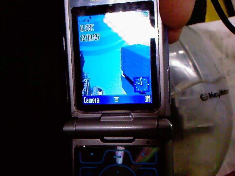

Another V3r Unlocked Done!!!

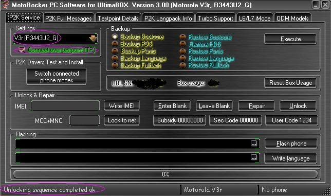

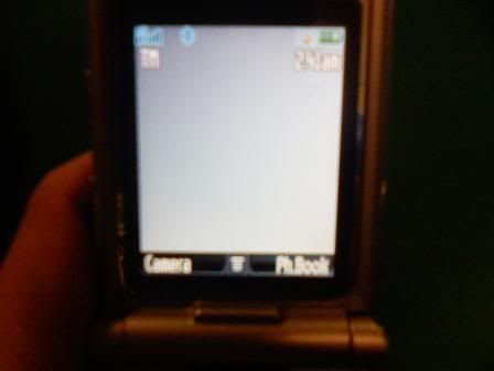

Bootloader
0A.52
Sw Version
R3443U2_G
TM SIM Used........
Sec only!!! hehehehehe!!!
