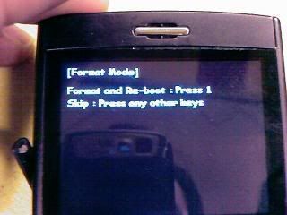

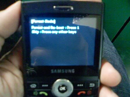

2. After 10mins... insert batt then press 0,ok,Right soft key ,back and power!!! at the same time!!!
After pressing this....This will take Effect on the Screen.......
3. The format Process ( just press 1 )

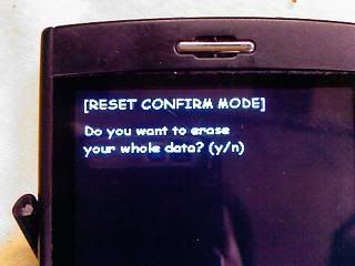

4. Then follows press Y (yes) for confirmation to format!!! ( format is 2-3 secs only)

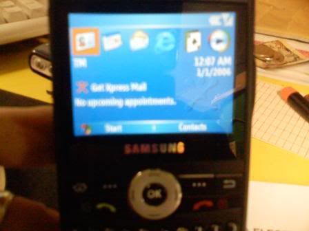

6. Insert an Original Sim (Cingular sim) when it shows start Button....Press start... or just type!!! *#1546792*# go to Network Mode-Select GSM and Network Order Also-Select GSM first!!!
7. Then Power it off...do not insert sim then Power it onn!!!
Note: when it activates you to start Button...Just type: *2767*3855 wait until it reboots totaly then return to start menu and this the time to Check the Lock... Just then type *#7465625 see the LOCK STATUS INFO. disabled all the enabled..........then power it off,......
8. Insert any simcard!!! Bang!!! it's nlock now!!!
