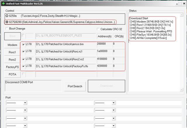

I've been trying to unlock this unit via flashing patch unlock file with Ns Pro but always getting error in flashing Rs1,Rs2 and file sytem.
Finally found solution for writing patch unlock files.:D
Thanks to Master Prolevelz for time spent helping me unlock this unit.

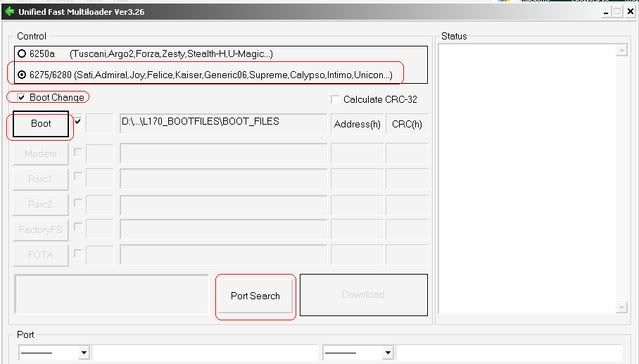

-First change boot using fastmultiloader
-L170 boot files here: http://www.4shared.com/file/60873507/43fc2d29/L170_BOOTFILES.html
-Fast multiloader here: http://www.4shared.com/file/60874989/f8504bfb/FastMultiLoader_V326.html
-open fast multiloader
-tick 6275/6280
-tick boot change
-tick BOOT tab and load your boot files
-use usb cable
-put unit in bootmode press 9+power connect usb cable
-wait till finish installing phone drivers
-tick port search to detect your unit
-once port is detected tick download tab
-after boot files are downloaded
-disconnect cable
 -load L170 Ns Pro patch files for unlock
-connect phone to cable press * phone will go to download mode
-tick port search once unit is detected tick download tab
-wait for downloading to finish
-after successfull download disconnect cable then wait for phone to finish formatting

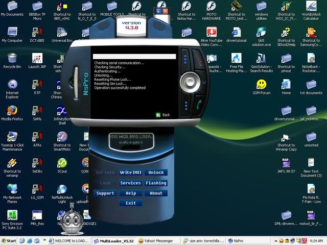

-open Ns Pro
-select L170 phone model
-power on unit connect to cable
-tick unlock tab

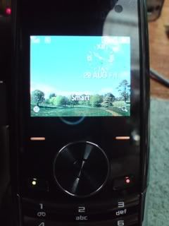

GUDO-GSM
  • Posts: 184
    • http://chennaigsm.org/forums/
L170 3G Globe locked unlocked using fastmultiloader and Ns Pro
« Reply #1 on: August 29, 2008, 11:19:22 AM »
All locks to globe like g800 l170 3g phone only for codes #7465625*638*00000000# tested by me 100%..
NO NEED FLASHING FOR LOCKS TO GLOBE TELECOM
