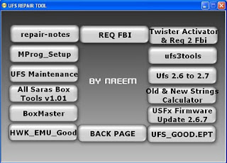

HWK / Ufs repair tool
« on: August 22, 2010, 02:54:42 PM »
http://www.4shared.com/file/LyGrDPhs/UFS_REPAIR_TOOL.html
