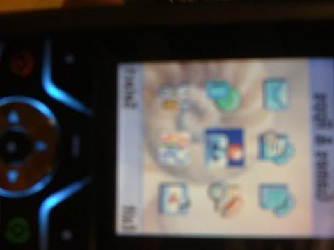

Smart-Clip / L6i Sw not Found: -Revive-
« on: March 26, 2008, 01:03:41 PM »
Via Prepare-Repair PDS & full flashed!
logs:
 SmartMoto 3.12
S-Card: 898...... Smart-Clip dongle, v 2.07, assigned Smart-Clip: 122...... Europe, initializing... OK
Clip serial: 122......, version: 4.07, initializing... OK
Searching for phone... found S Flash Neptune LTE, getting test interface... interface not found
Switching to flash mode... OK
Reading phone boot version... 8.D5
Sending boot... OK
Erasing flash memory OK
Sending firmware OK
Searching for phone... found S Blank Neptune LTE
Reading phone boot version... 2.00
Reading flash id... Intel - 28F256L18B
Phone group: A630,E1,E37x,E39x,E55x,L6,U6,V3,V190,V330,V53x,V54  x,V55x,V62x,V635,V80
Hardware IMEI: 353010016......
IMEI OTP status: locked
Security area saved to "PDS for S Blank Neptune LTE 353010016.......mbk"
Unlocking phone... "Prepare phone" operation failed
error A0
Login request... OK
Writing flash section 4 of 4... 100% (9.35 Kb/sec)
Restarting phone... OK
Repair PDS request... OK
Performing PDS repair... OK
Writing flash section 1 of 1... 100% (15.8 Kb/sec)
Please write a corresponding Full_flash file to phone to complete repair
Writing flash section 2 of 2... 100% (54.8 Kb/sec)
Turning phone off...  OK
Flash completed!
