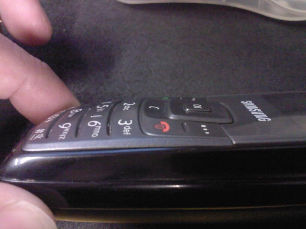

Samsung Hardware-Repair Area / F.Y.I Sgh-C140 dont expose not much heat!
« on: November 09, 2007, 02:33:34 PM »
Even low heat but continuesly exposed to it!
the keypad easily expand! It will turn to be like this!
It was stock for 3days at the drawer even a aircondition room!
So.,,better watch out!

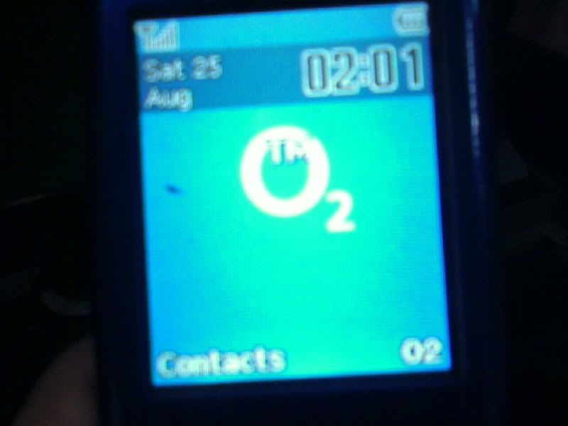

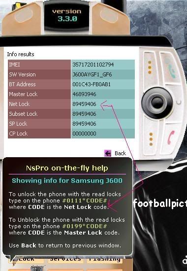

199
NSPRO / The Easy way to Unlock SGH-J600
« on: November 08, 2007, 11:42:25 AM »
SGH-J600 O2
just tick GET Info!
Then Follow the Fly-Help option! Until you see the personalized Cancelled! then the Phone will Reboots.Then,DOne!
Simply like that!

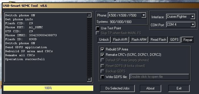

205
Sony Ericson Software / F500 Blinking! Repaired!
« on: November 03, 2007, 10:43:10 AM »
Go to the Repair Area
tick Rebuild SP Data
tick Remake CRC's!
Done!
I have dismantled the unit
Because when i insert cable,it cannot be detected!
So i have repaired it through resoldering charging pins!!!

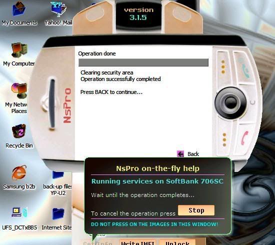

209

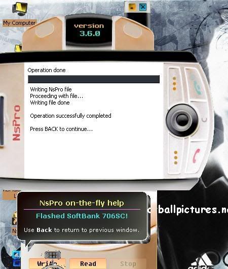

NSPRO / 706sc dl 2.30 2007.02 unlocked!
« on: October 30, 2007, 12:20:14 PM »
Flash it via Patch file!
*Select flashing
*Tick Ns Pro file!
*Load patch unlock file!
*then write!
Wait for minutes! (3mins)
Then:
Use Ns pro version-3.1.5
*Select services
*Tick Start to clear it all!
*done! UNLOCKED!
I dont know why is the new  version disabled the option of services!
so all you have to is uninstall and install the lower version tested by me V3.1.5
Note: Do not use Zxxxx Cable anymore!
Services is another way of unlocking in sc type!
Always press 9+power when ask!
