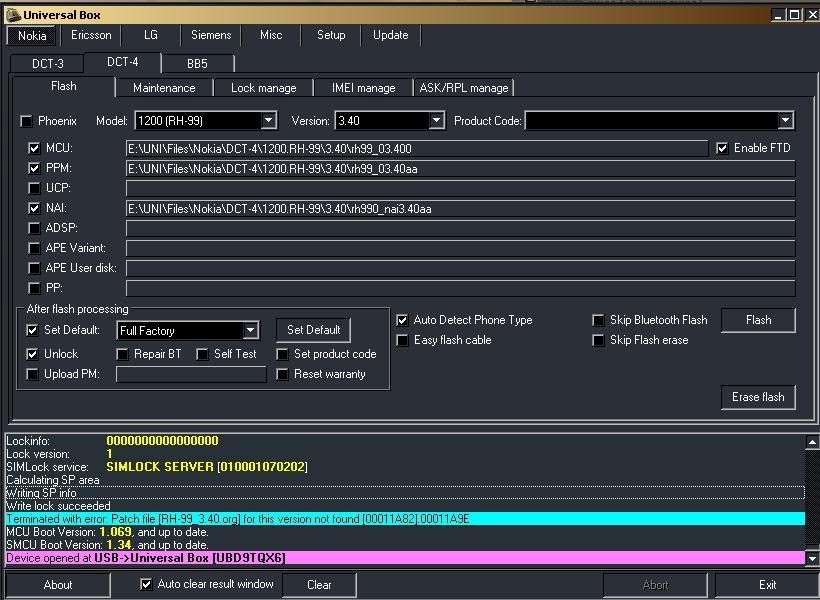

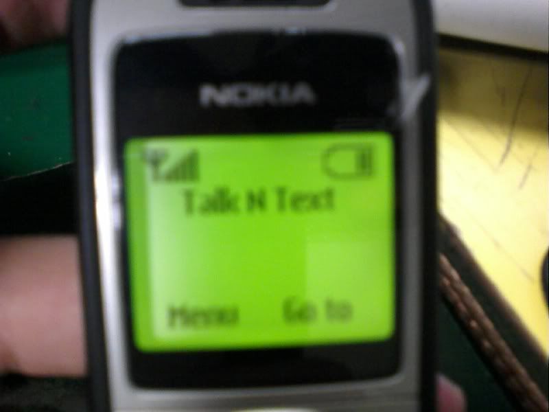

Universalbox Dongle / 1200 v3.44 unlocked done!!!
« on: November 23, 2007, 12:52:29 PM »
PROCEDURE:
1. OPEN UB-BOX software
2. GO TO DCT4/FLASH TAB
3. SELECT MODEL: RH99 VERSION: 3.40
4. LOAD MCU: rh99_03.400 PPM: rh99_03.40aa NAI: rh99_nai3.40aa
5. put check on UNLOCK (after flash processing option)
6. remove/delete RH-99_3.40.org in C:\Uni\Files\Nokia\DCT-4\Patch
note: every time you will unlock 1200 units be sure that RH-99_3.40.org was
already removed to that folder to avoid contact service.
7. now press FLASH
8. WAIT UNTIL IT FINISH (FLASHING AND UNLOCKING)
note: some error will be happened at the end of process due to missing of
RH-99_3.40.org in C:\Uni\Files\Nokia\DCT-4\Patch "but don't panic..."
VIOLA YOUR PHONE IS UNLOCKED/REVIVED
Locked Globe:
Opened!
Special thanks to sir Sandman and Sir ShawGsm

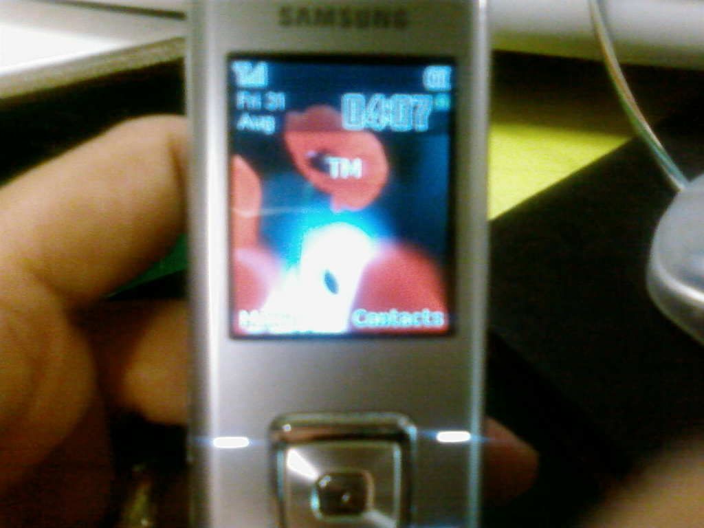

NSPRO / SGH-709sc 2007.01 Unlocked!!!
« on: November 22, 2007, 08:54:13 AM »
I used my own made Zxxxx cable!!!

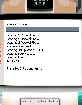

* Select flashing -flash it with patch unlock
Logs: After flashing Patch unlock!
Writing NsPro file
Proceeding with file...
Writing file done
Press BACK to continue...
* Go back then Unlock it!Just only a second!
Done!
Note:
Press 9+power when ask!
after pressing 9+power you will see
Download 1.01
Plume_HSDPA
After unlock
put a sim then After power
goto
MENU,Settings,Connectivity,Network Mode and Select GSM 900/1800
