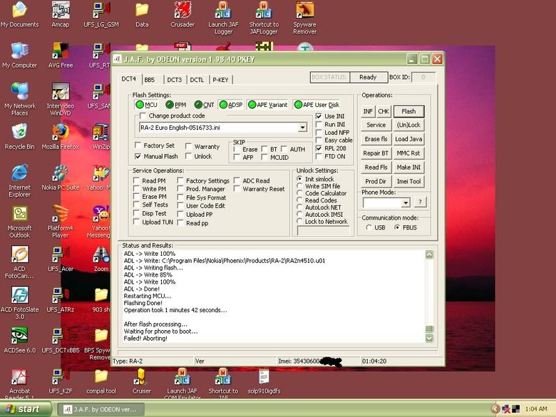

WD2 Section / Nokia 6620 White Screen Reolved...
« on: March 25, 2008, 10:58:20 PM »
Nokia 6620 white screen problem Flash using Jaf same result, after reheating CPU Flash again phone now is working .
Here is the log:
Detected PKEY: Papa Sol
20:03:2008  18:48 -> Card life counter: 95.45%
20:03:2008  18:48 -> P-key nokia module version 01.00
20:03:2008  18:49 -> Detected UFS_USB V2.6 (c) SarasSoft 2005. version: 01.B0, Driver version: 0, Library version: 0
20:03:2008  18:49 -> JAF DCT4/BB5 LOADERS DIR: C:\Program Files\ODEON\JAF\Flash\
20:03:2008  18:49 -> JAF DCT4/BB5 PRODUCT DIR: C:\Program Files\Nokia\Phoenix\Products\
20:03:2008  18:49 -> JAF USB LOADERS DIR: C:\Program Files\ODEON\JAF\FlashUSB\
20:03:2008  18:49 -> JAF DCT3/DCTL LOADERS DIR: C:\Program Files\ODEON\JAF\Flash3\
20:03:2008  18:49 -> FILES SET FOR FLASHING:
20:03:2008  18:49 -> MCU Flash file: NONE
20:03:2008  18:49 -> PPM Flash file: NONE
20:03:2008  18:49 -> CNT Flash file: NONE
20:03:2008  18:49 -> ADSP Flash file: NONE
20:03:2008  18:49 -> APE Variant file: NONE
20:03:2008  18:49 -> APE User Flash file: NONE
20:03:2008  18:49 -> Phone Type:
20:03:2008  18:49 -> MCU Flash file: C:\Program Files\Nokia\Phoenix\products\nhl-12\NHL123141.CMT
20:03:2008  18:49 -> ADSP Flash file: C:\Program Files\Nokia\Phoenix\products\nhl-12\NHL123141.C1
20:03:2008  18:49 -> APE Variant file: C:\Program Files\Nokia\Phoenix\products\nhl-12\NHL123141.V01
20:03:2008  18:49 -> Backing up PM Field 208 as RPL...
20:03:2008  18:49 -> Setting local mode...
20:03:2008  18:50 -> Failed! Aborting!
20:03:2008  18:50 -> Failed to backup imei...
20:03:2008  18:50 -> MCU: 20:03:2008  18:50 -> C:\Program Files\Nokia\Phoenix\products\nhl-12\NHL123141.CMT20:03:2008  18:50 ->
20:03:2008  18:50 -> Booting phone...
20:03:2008  18:50 -> MCU ID: 0x0000
20:03:2008  18:50 -> This MCU ID is not supported in chosen flash file...
20:03:2008  18:50 -> Error booting phone...
AFTER REHEATING THE CPU BELOW LOG YOU WILL NOTICE THERE IS AN ERROR AT THE END:
20:03:2008  19:28 -> Card life counter: 95.17%
20:03:2008  19:28 -> P-key nokia module version 01.00
20:03:2008  19:28 -> Detected JAF INTERFACE version: 01.B0, Driver version: 40000, Library version: 30107
20:03:2008  19:28 -> JAF DCT4/BB5 LOADERS DIR: C:\Program Files\ODEON\JAF\Flash\
20:03:2008  19:28 -> JAF DCT4/BB5 PRODUCT DIR: C:\Program Files\Nokia\Phoenix\Products\
20:03:2008  19:28 -> JAF USB LOADERS DIR: C:\Program Files\ODEON\JAF\FlashUSB\
20:03:2008  19:28 -> JAF DCT3/DCTL LOADERS DIR: C:\Program Files\ODEON\JAF\Flash3\
20:03:2008  19:28 -> FILES SET FOR FLASHING:
20:03:2008  19:28 -> MCU Flash file: NONE
20:03:2008  19:28 -> PPM Flash file: NONE
20:03:2008  19:28 -> CNT Flash file: NONE
20:03:2008  19:28 -> ADSP Flash file: NONE
20:03:2008  19:28 -> APE Variant file: NONE
20:03:2008  19:28 -> APE User Flash file: NONE
20:03:2008  19:28 -> Phone Type:
20:03:2008  19:28 -> MCU Flash file: C:\Program Files\Nokia\Phoenix\products\nhl-12\NHL123141.CMT
20:03:2008  19:28 -> ADSP Flash file: C:\Program Files\Nokia\Phoenix\products\nhl-12\NHL123141.C1
20:03:2008  19:28 -> APE Variant file: C:\Program Files\Nokia\Phoenix\products\nhl-12\NHL123141.V01
20:03:2008  19:29 -> Backing up PM Field 208 as RPL...
20:03:2008  19:29 -> Setting local mode...
20:03:2008  19:29 -> Failed! Aborting!
20:03:2008  19:29 -> Failed to backup imei...
20:03:2008  19:29 -> MCU: 20:03:2008  19:29 -> C:\Program Files\Nokia\Phoenix\products\nhl-12\NHL123141.CMT20:03:2008  19:29 ->
20:03:2008  19:29 -> Booting phone...
20:03:2008  19:29 -> MCU ID: 0x1130
20:03:2008  19:29 -> BOOT file: C:\Program Files\ODEON\JAF\Flash\u_2nd.fia
20:03:2008  19:29 -> Loader version: 04.46.0120:03:2008  19:29 ->  -> Revision: 0007
20:03:2008  19:29 -> Boot size is 0x09A0
20:03:2008  19:29 -> Boot is ready...
20:03:2008  19:29 -> FLASH ID0: 0001247E -> AMD Addr0: 0x01000000 - 0x01FFFFFF, SectorSize0: 10
20:03:2008  19:29 -> FLASH ID1: 00000001 -> NOT USED Addr1: 0x02000000 - 0x02FFFFFF, SectorSize1: 0
20:03:2008  19:29 -> First 16 bytes: 20:03:2008  19:29 -> FF FF FF FF FF FF FF FF FF FF FF FF FF FF FF FF
20:03:2008  19:29 -> Flash ID is 0x7E240100
20:03:2008  19:29 -> Flash loader is C:\Program Files\ODEON\JAF\Flash\m_amd.fia
20:03:2008  19:29 -> Loader size is 0x8130; Loader chk: 19
20:03:2008  19:29 -> Loader is ready...
20:03:2008  19:29 -> P-key nokia module version 01.00
20:03:2008  19:30 -> MSID: 8441D81D96003F46EEA2E7503F
20:03:2008  19:30 -> MSID decoded: 3E4EBAE900444A30A8000000
20:03:2008  19:30 -> FAID: 6A2F48E12699B1C1CAC43EC9
20:03:2008  19:30 -> Operation took 0 minutes 31 seconds...
20:03:2008  19:30 -> Erasing...
20:03:2008  19:30 -> Found 2 interval(s) to erase
20:03:2008  19:30 -> Erasing area: 01000000 - 0100FFFF...
20:03:2008  19:30 -> Erasing area: 01010000 - 012FFFFF...
20:03:2008  19:30 -> Operation took 0 minutes 37 seconds...
20:03:2008  19:30 -> Writing...
20:03:2008  19:31 -> Perm. Data Restore OK
20:03:2008  19:31 -> Operation took 0 minutes 22 seconds...
20:03:2008  19:31 -> Restarting MCU...
20:03:2008  19:31 -> Flashing Done!
20:03:2008  19:31 -> Operation took 2 minutes 22 seconds...
20:03:2008  19:31 ->
20:03:2008  19:31 -> After flash processing...
20:03:2008  19:31 -> Waiting for phone to boot...
20:03:2008  19:31 -> Reading...
20:03:2008  19:31 -> Phone type: NHL-12, Software version: 3.14.1
20:03:2008  19:31 -> IMEI: 35375500058xxxx
20:03:2008  19:32 -> Product Code:
20:03:2008  19:32 -> Resetting PPC...
20:03:2008  19:32 -> Error PPC reset!
20:03:2008  19:32 -> Failed! Aborting!

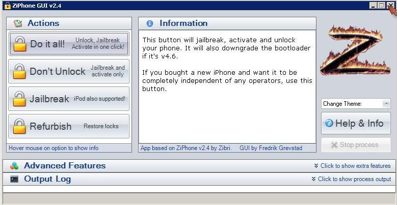

Various Mobile / ZiPhone 2.4 released (iPhone unlock TooL)...
« on: February 22, 2008, 08:48:59 PM »
2.4 Ziphone
Best Regards!!!

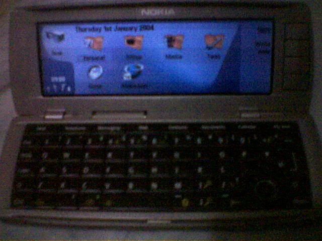

DCT4 Section / 9500 Dead....
« on: November 09, 2007, 05:05:29 PM »
Just lucky 9500 dead revived by JAF.
Maybe you will be confuse regarding the LOGS.
