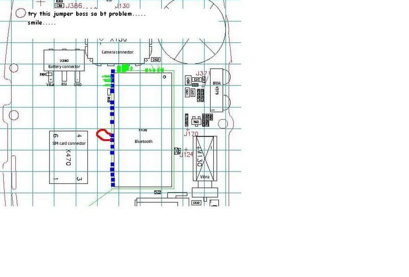

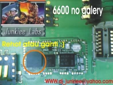

Quote from: -=NeO=-;684
I. try to format...
II.
1) make a jumper
(you can see the red line jumper of
bluetooth ic) then assemble the mobile,
turn it on
2) OPEN FIRST THE GALLERY
WITHOUT MEMORY CARD,THEN OPEN ALL THE
IMAGES,MUSIC ETC. INSIDE OF YOUR GALLERY
3) TIME TO TURN ON YOUR BLUETOOTH
4) PUT BACK
THE MEMORY CARD AND DO 2 AND 3
5)then remove the jumper and do step
2,3,4..if still the cannot open again,
put the jumper and reheat the bluetooth
ic and repeat it step 1,2,3,4
III.REFLOW OR CHANGE
regard
..::ShaDow::..
