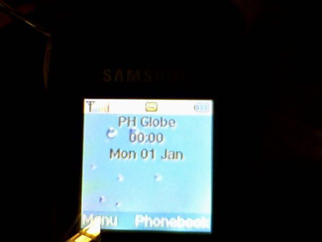

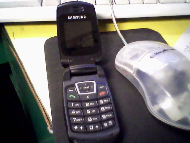

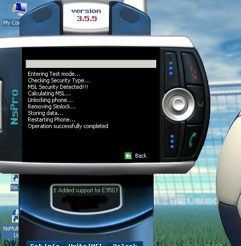

Use same cable with SGH-C140
pinouts is at the support area!
but i have tried it before this kind of unlocking this model C260 the other month!!!
you can unlocked through this steps!!!
First with different carrier SIM in phone at WRONG CARD screen ENTER on the keypad
*2767*3855# (wait 10-15 seconds) phone will reboot(restart)it will erase all!
When phone completes reboot ENTER
*7465625*638*00000000*00000000#
NEXT ENTER
#7465625*638*00000000#
AND THEN *#7465625# to check the locks....all locks are inactive...these are all the locks...
network lock - inactive
subset lock - inactive
sp lock - inactive
cp lock - inactive
sim lock - inactive
activa lock - inactive
phone lock - inactive
auto network - inactive
auto subset lock - inactive
auto sp lock - inactive
auto cp lock - inactive
auto sim lock - inactive
