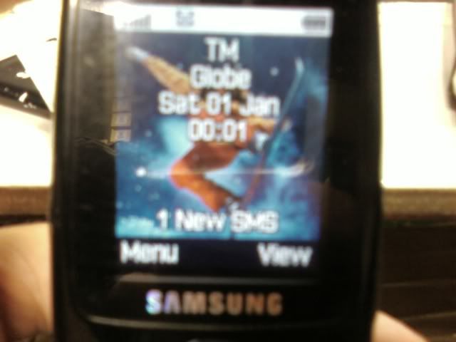

Problem: when you power onn,only SGH-X620
then hangs--------

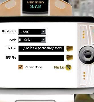

Flash only with binary
Set Speed to the Lowest
Then Tick Repair mode!!!
Then after flashing (and you have tick the repair mode so Your IMEI was OOOOOOOOOOO Zeros after flashing)Just repair the imei!!!
Logs of Repair IMEI!!!
Entering TAT Mode...
Proceeding changing IMEI...
Writing IMEI...
SGH-X620 Hang-up Repaired!!!
