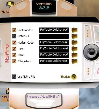

Auto-off!Flashed Succesfull!
After Flashing don't disconect the cable yet!!! Wait for 5secs for the Unit to reboot!!! wait for the main menu!!! then get the cable then
E2p *2767*3855#

sir kindly post the procedure and the flashfile you used on flashing?

Step by step
open sw!!!
select model Z240
tick flashing
load all the files check it except for USB boot!!!
then tick write!!!
thats all of the step!
now flashfile is at the support area of ns pro!!!
