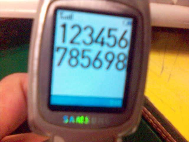

Sgh-E310 Hang up! when it power onn only SGH-E310 you can see!
I have disabled the side keys,varistor,mic! no luck!

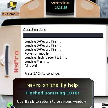

so i have flashed it with full flash file! downloaded at support area of ns pro!
Then in flashing tick also the repair mode!
after flashing write imei! reveal the real imei at the back of the unit!
Then costum reset and E2p reset!
Done!
I can type now!Works well!
