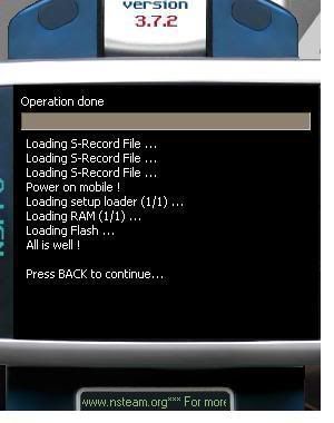

Logs:
Entering Test mode...
Checking Security Type...
Operation failed!
Now! if you have error like that!!! It is a damage NVM
Just load NVM Files via flashing... just dl at the support area of NS pro!!!
The same settings then write it!!!
logs:
Operation done
Loading S-Record File ...
Power on mobile !
Loading setup loader (1/1) ...
Loading RAM (1/1) ...
Loading Flash ...
All is well !
Press BACK to continue...

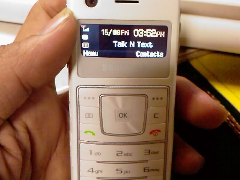

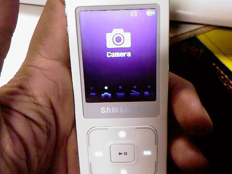

Then
Costum reset
and
e2p reset
Then insert SIM.....hehehehehehe
