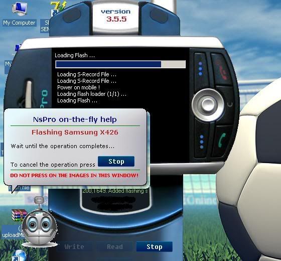

Flash it first with
flashfile (X427_GSM900_FREE.s3)

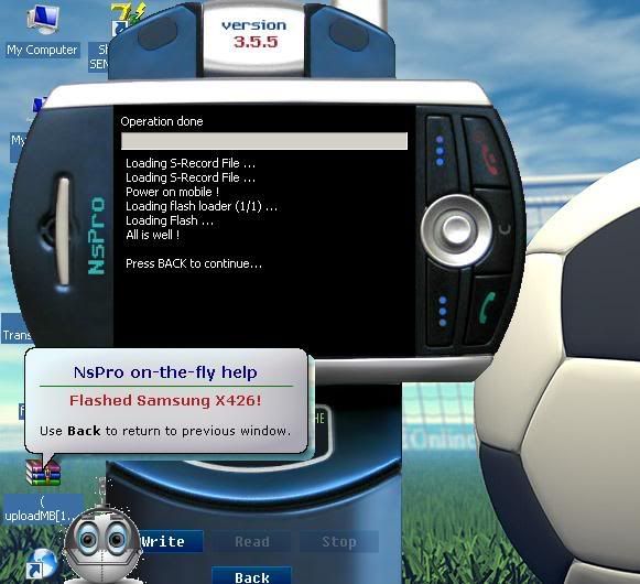

after flashing no error!!!
flash it again!!!

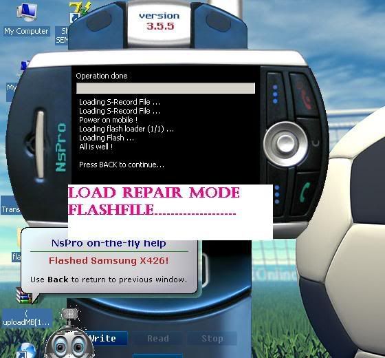

with this
(X427_GSM900_2_No_REPIAR_MODE.s3)

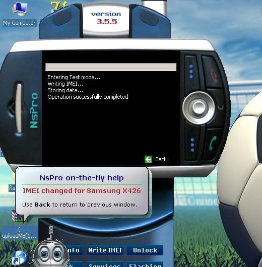

then write/reveal the imei!!!

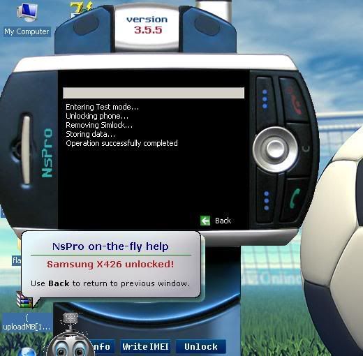

then unlock!

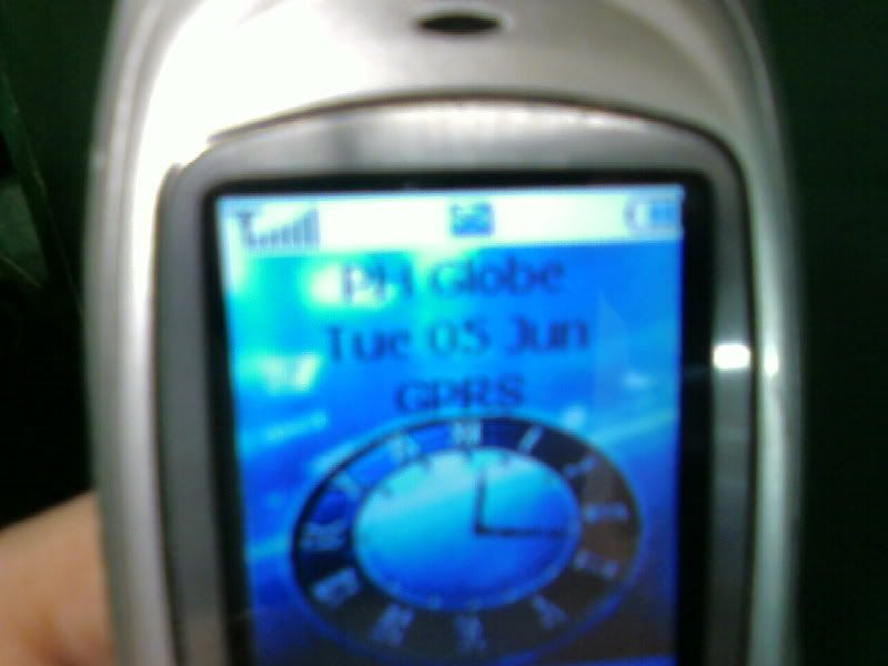

then change the langauge press menu 5,4 and 1(select desired language-english-)
then Network settings Band Selection Select 1800/1900
