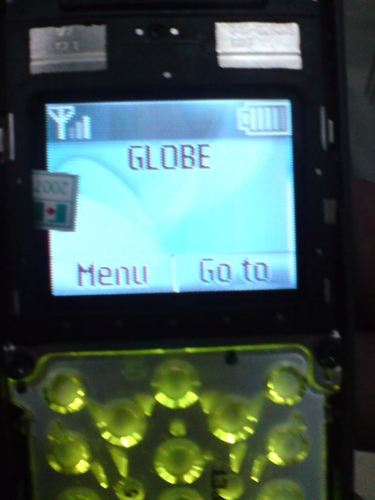

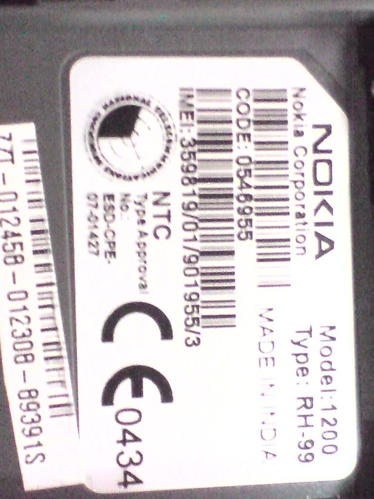

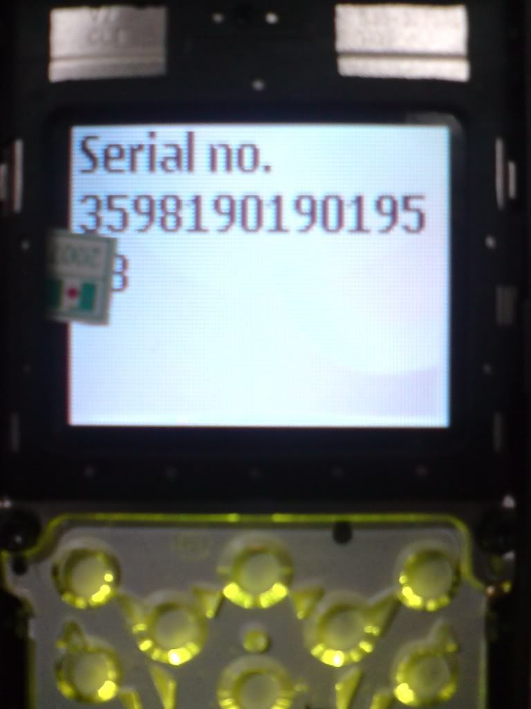

1200 rh-99 convert to 1208 rh-105
1. Make erase flash with Jaf tick full erase
2. Flash unit with 1208 rh-105 f.w. mcu+ppm+cnt
3. Write good pm file, after write pm make unlock
4. make full factory defaults.
5. replace units lcd with nokia 1600 lcd.
