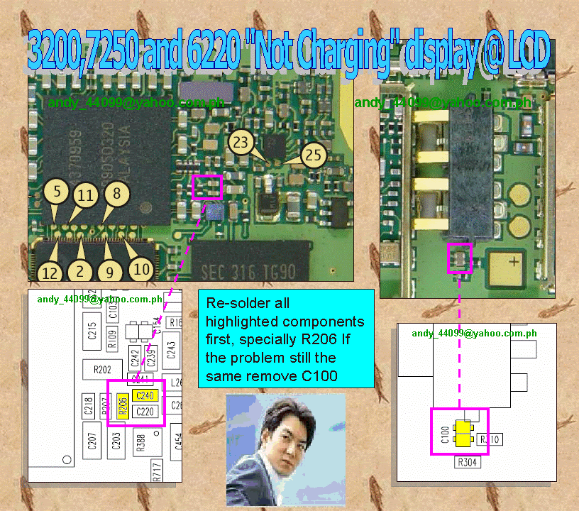

1100 2300 not charging
http://i167.photobucket.com/albums/u155/cjwong/11002300arz.gif[/IMG]]

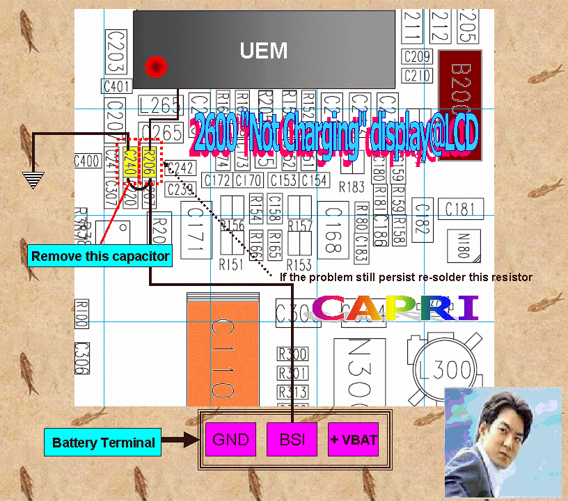

2600 not charging
http://i167.photobucket.com/albums/u155/cjwong/2600arz.gif[/IMG]]

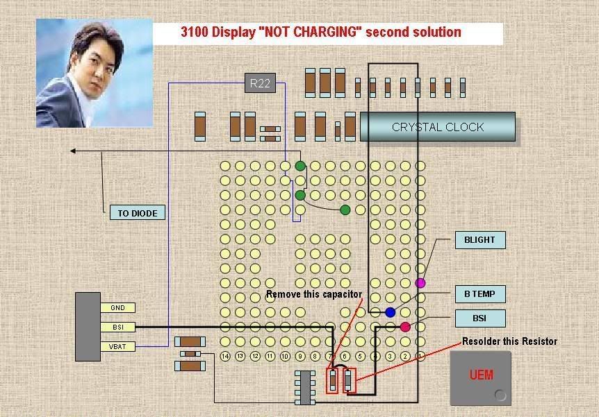

3100 not charging
http://i167.photobucket.com/albums/u155/cjwong/3100arz.jpg[/IMG]]
3200-7250 not charging
http://i167.photobucket.com/albums/u155/cjwong/3200-7250.gif[/IMG]]

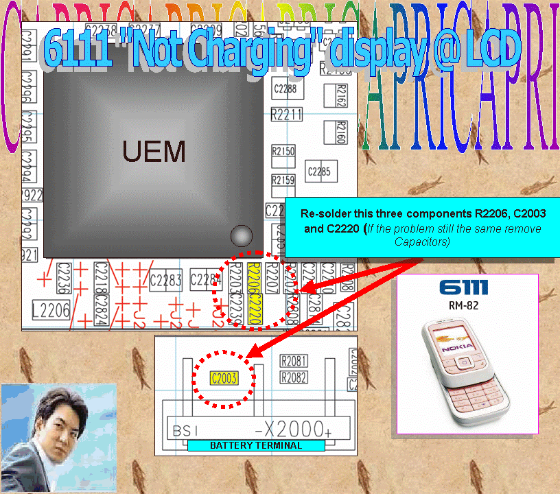

3230 not charging
http://i167.photobucket.com/albums/u155/cjwong/3230Notcharging.gif[/IMG]]

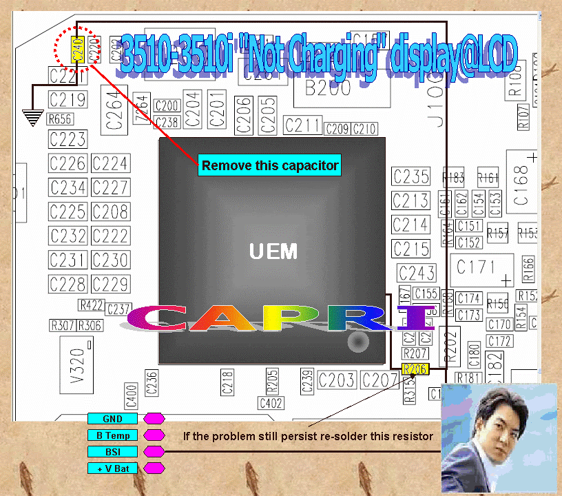

3510 not charging
http://i167.photobucket.com/albums/u155/cjwong/3510arz.gif[/IMG]]

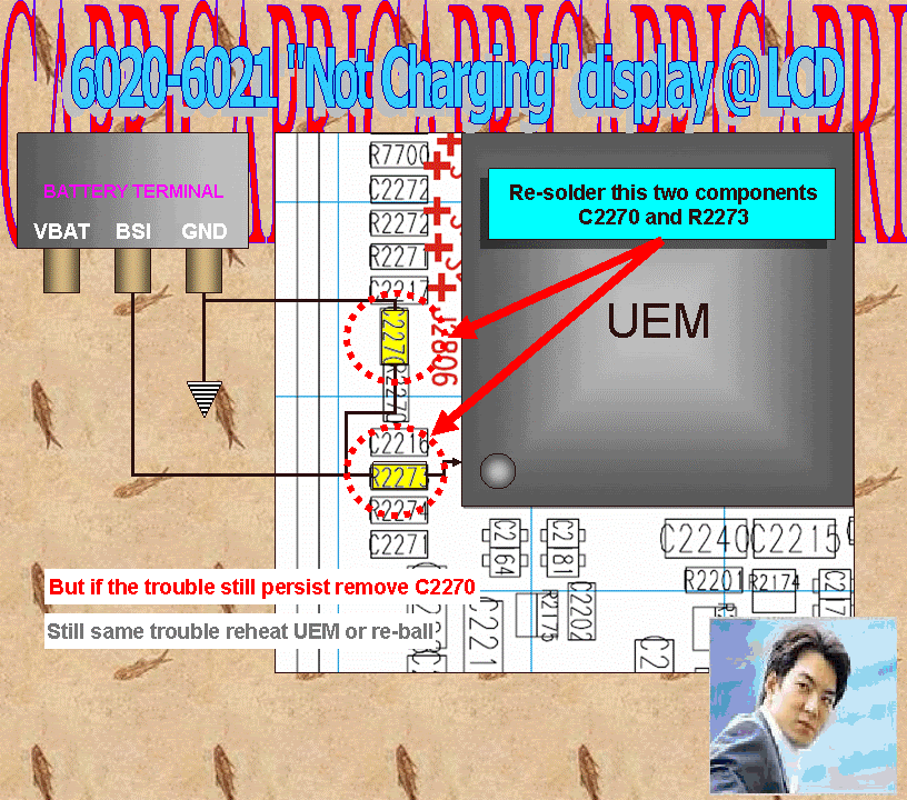

6020 not charging
http://i167.photobucket.com/albums/u155/cjwong/6020.gif[/IMG]]

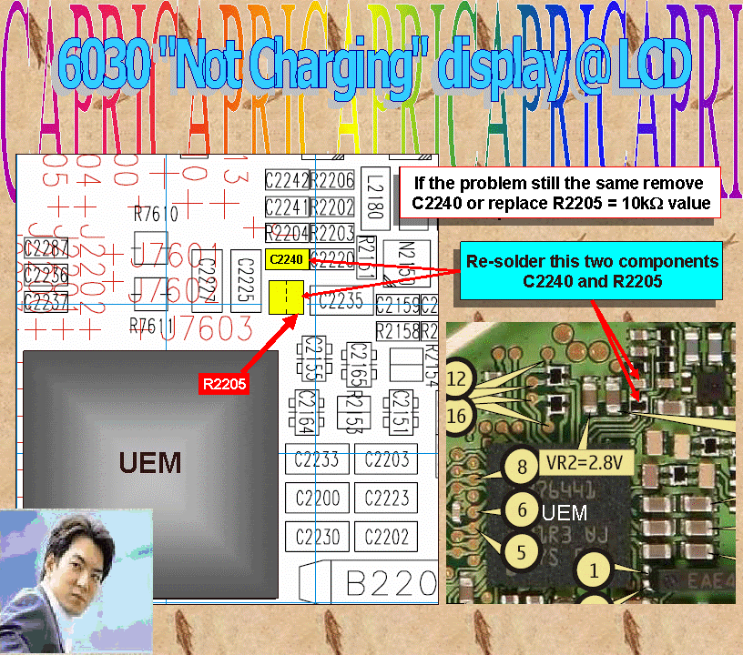

6030 not charging
http://i167.photobucket.com/albums/u155/cjwong/6030arz.gif[/IMG]]
6070 not charging
http://i167.photobucket.com/albums/u155/cjwong/6070notcharging.gif[/IMG]]
Br,

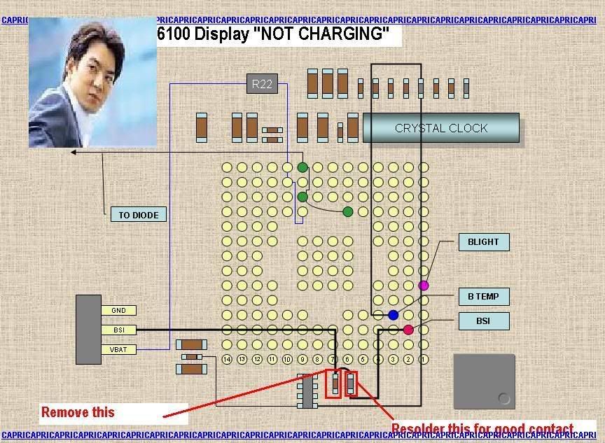

6100 not charging
http://i167.photobucket.com/albums/u155/cjwong/6100arz.jpg[/IMG]]

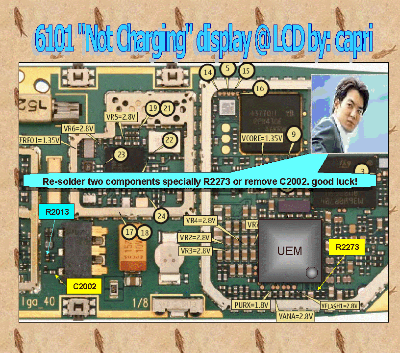

6101 not charging
http://i167.photobucket.com/albums/u155/cjwong/6101Notcharging.gif[/IMG]]
6111 not charging
http://i167.photobucket.com/albums/u155/cjwong/6111Notcharging.gif[/IMG]]

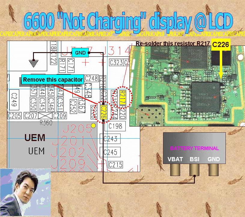

6600 not charging
http://i167.photobucket.com/albums/u155/cjwong/6600arz.gif[/IMG]]

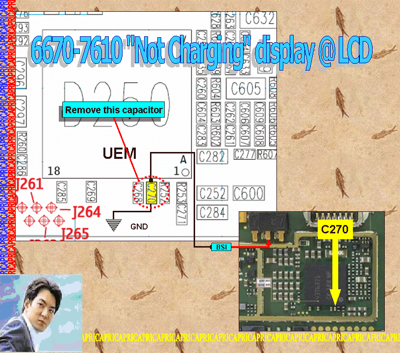

6670 not charging
http://i167.photobucket.com/albums/u155/cjwong/6670arzolmuyor.gif[/IMG]]

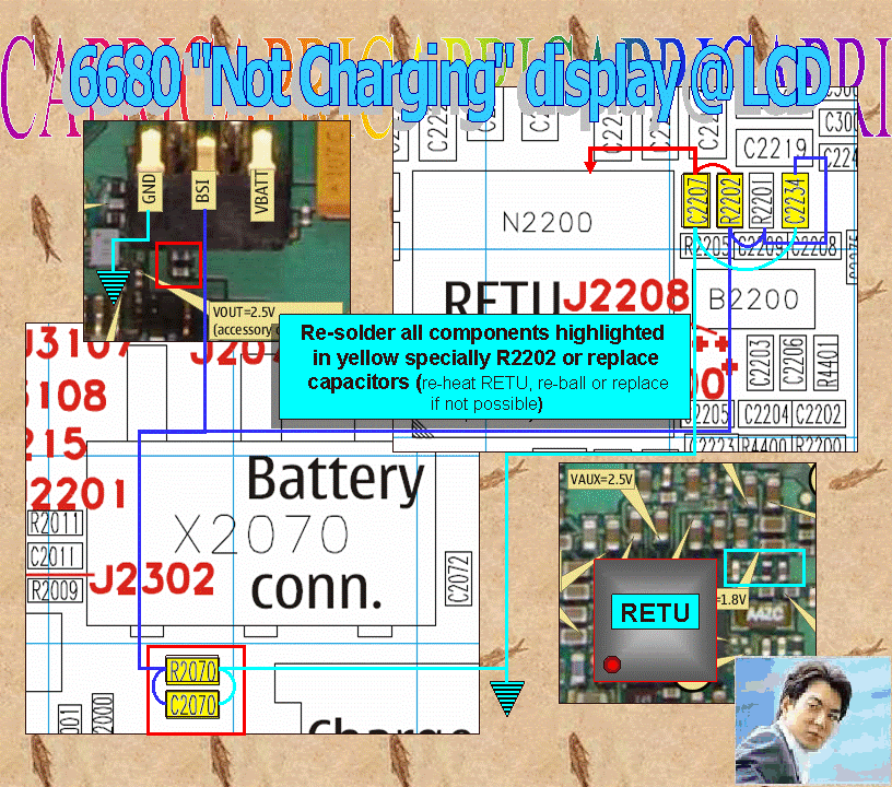

6680 not charging
http://i167.photobucket.com/albums/u155/cjwong/6680arzolmuyor.gif[/IMG]]

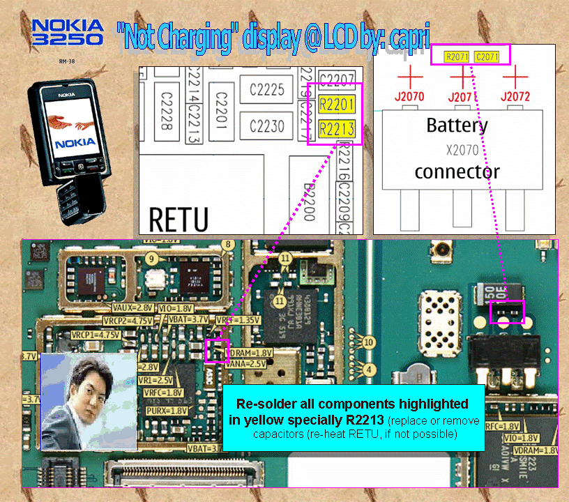

3250 not charging
Br,
