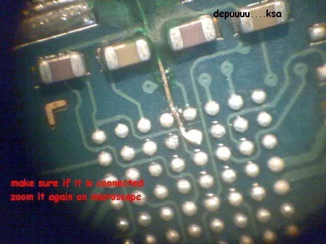

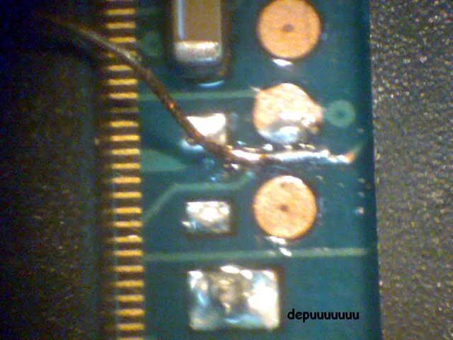

                        CORODED JUMPER UNIT
                       zZOOMED VIVA MICROSCOPE
                       zzZOOMED 2X VIVA MICROSCOPE
                        VINKU IS THE NEAREST IC,THATS WHY WE CHOOSE IT TO PLACE THE JUMPER

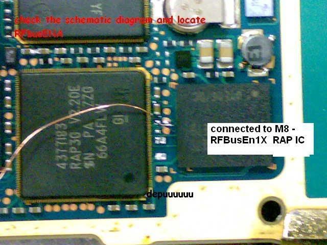

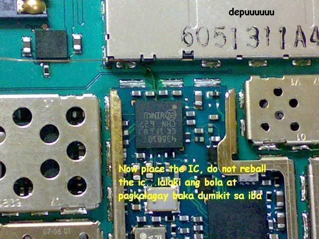

                    NOW PLACE THE IC,DO NOT REBALL THE IC
                 CONECTED 2 M8-RFBUS EN1X RAP IC

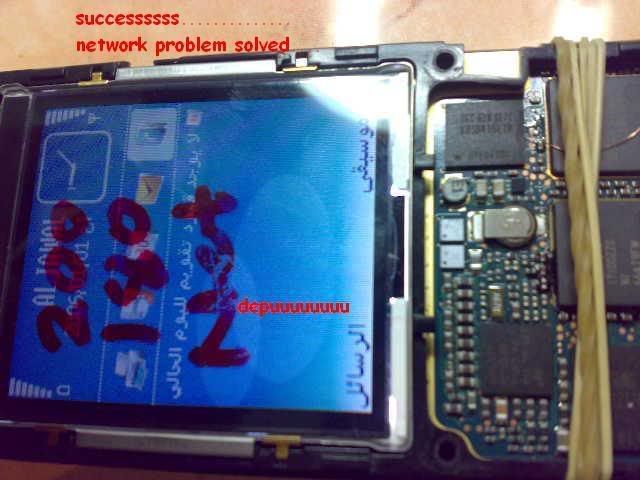

                   FINNALY CONECTED WELL

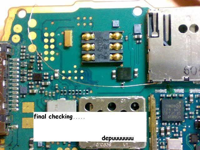

                  FINAL CHECKING WIRE
                 SUCESS NETWORK PROBLEM SOLVED
