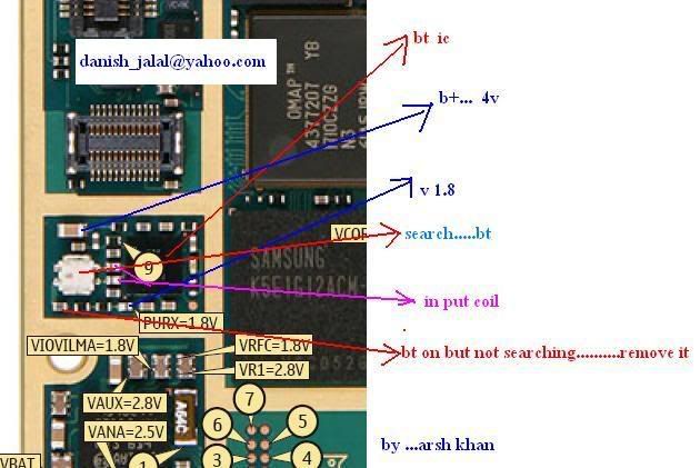

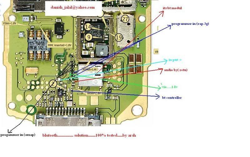

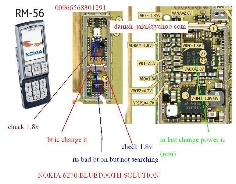

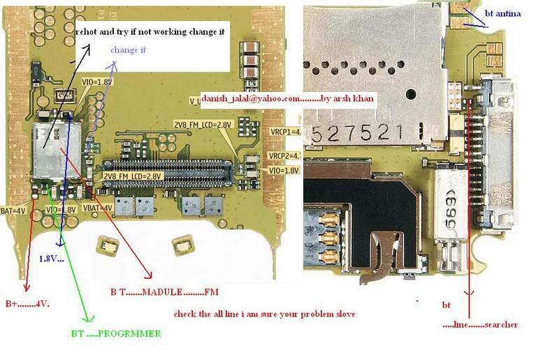

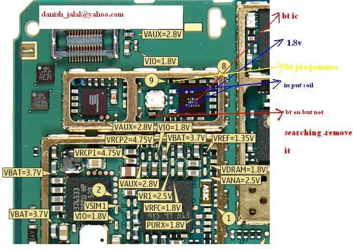

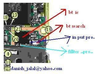

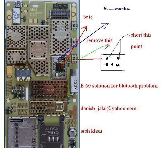

BB5 Bluetooth Solution here!!!
« on: October 20, 2007, 08:23:32 AM »
3250
6270
6280
6680
E60
N70
N73
N80
