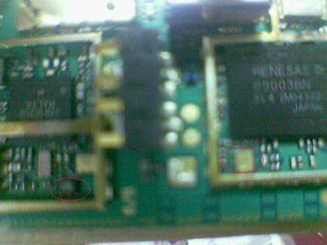

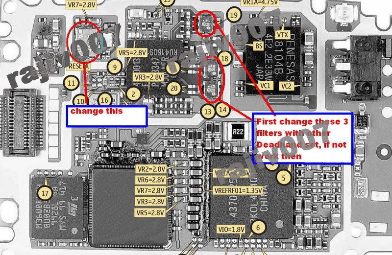

6010 to 3530
1. Back up rpl
2. change flash i.c, 3510i or 3530 flash i.c,then
3. add a ram to it
4. flash it to 3510i,,use rh9 v5.35 flash file
5. change the 3 filters the 850/1900 mhz rx and 1900 mhz tx filter,
6. put a jumper from uem to pa
7. write pm
8. unlock

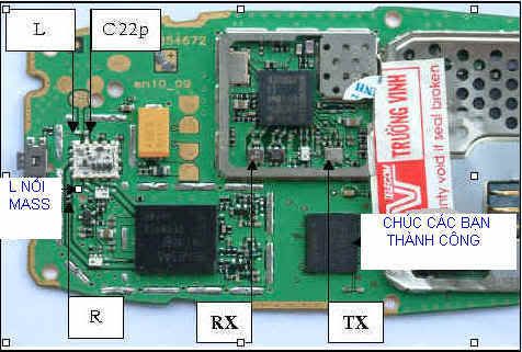

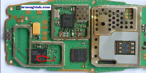

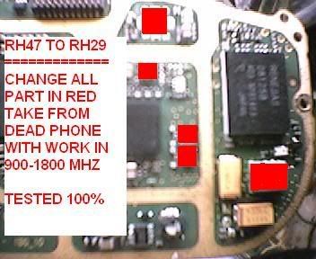

2651 to 2650
1. Change filters shown in the picture u can use filters from nokia 3100
2. Full flash with 2650 files(Mcu,ppm,cnt)
3. Write a good pm
4. unlock
« Last Edit: March 30, 2008, 02:57:27 PM by mani6 »

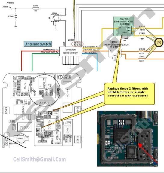

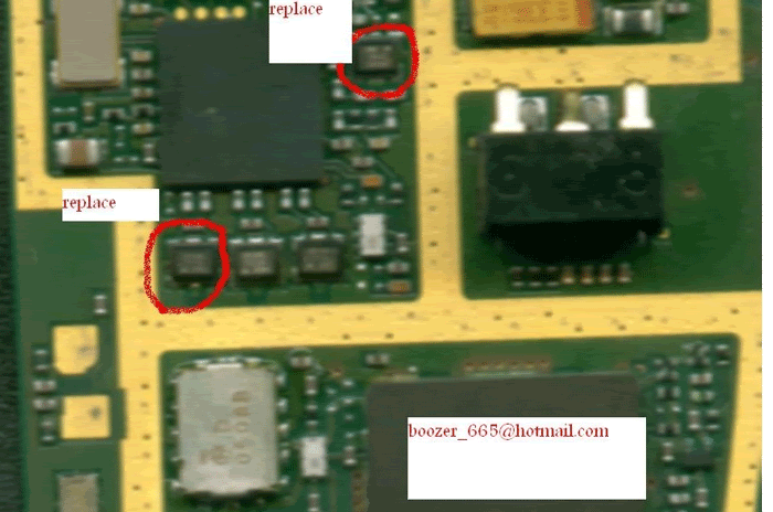

6103b to 6103
No software modification is required
(6103b supports 900mhz)
change 2 filters
then write 6103 PM
unlock
« Last Edit: March 30, 2008, 02:57:41 PM by mani6 »

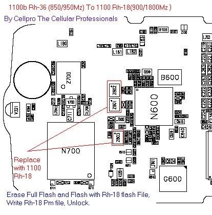

1100b to 1100
1. erase flash
2. flash with 1100(rh18)
3. change filters
4. write pm
5. unlock
« Last Edit: March 30, 2008, 02:58:28 PM by mani6 »

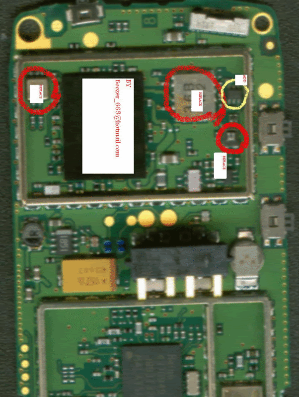

3220b to 3220
1. change filters
2. upload pm
3. unlock
« Last Edit: March 30, 2008, 02:58:54 PM by mani6 »

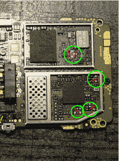

6200 to 6610
1. flash phone with nhl-4u (6610) mcu + ppm
2. replace filters
3. write pm
4. unlock

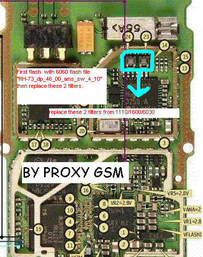

6061 to 6060
1. erase whole flash as 6060.
2. flash ur 6061 with 6060 flash pack "RH-73_dp_46_00_ams_sw_4_10".
3. replace 2 filters
4. write pm
5. unlock

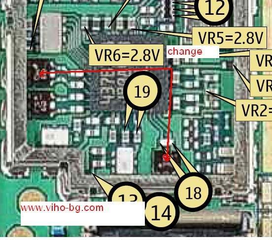

2610b CONVERTION
1. Change the rx filter 2610b got it any other phone
2. Dont Flash
3. Write a good pm 2610
4. unlock
