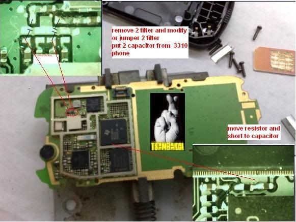

Procedure
> Unlock the phone
> Remove 2 filter and modify
> Move resistor and short to the capacitor
:P

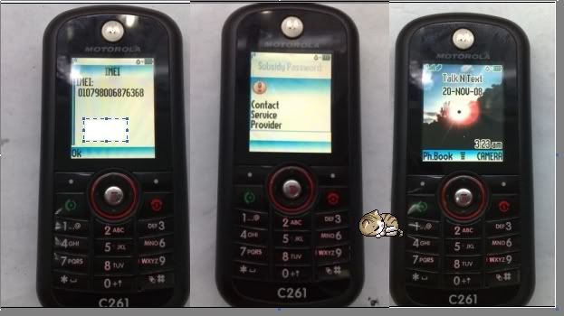

Unlocking phone...OK
Turning phone off
http://i277.photobucket.com/albums/kk57/GREENTELCOM/c261-3.jpg[/IMG]]
http://i277.photobucket.com/albums/kk57/GREENTELCOM/modification.jpg[/IMG]]
IMEI/                                           PROVIDER/                                         UNLOCKED
http://i277.photobucket.com/albums/kk57/GREENTELCOM/provider.jpg[/IMG]]
