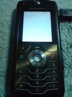

Recieved this unit yesterday when powered-up just keypad lights then power-off. Pressed *,# power to display bootloader ver. but just white screen only. First tried flashing with rsdlite and scout flasher flashing completed but still same problem. Tried to prepare phone via tp in smart moto but always error boot ver. So I did repair pds instead and full flash unit with smart moto via tp procedure still same problem. Imei patch and rebuild ime still same problem. Posted problem at smart clip section of Gsm Hosting

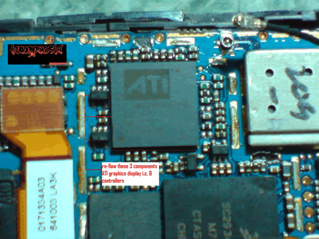

thanks to Orange Dominica for the solution. It was hardware problem reflow Ati graphics chip and controllers besside the chip. Now unit is in working condition.
Reflow this Ati graphics chip :
