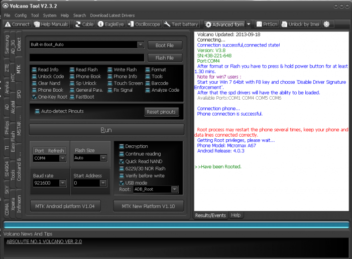

 1st go to MTK Tab select default Built-in Boot _ Auto
 2nd click on one key root
 3rd untick Auto Detect Pinout
 4th select usb mode .
 5th select ADB_Root
 6th power on ur phone after on screen u will see enter gmail id & pass
 Click on Run
 connect your phone with pc ...
 after that u see connection phone
 phone connection is successful
 Root process may restart the phone several times, keep your phone and data lines connected correctly.
 Getting Root privileges, please wait...
 Phone Model: Micromax A67
 Android Release: 4.0.3
 wait for the full process it may takes maximum 5 to 7 mins just wait after root success phone is reboot
 after root just change the option
 now select Reset_Gmail
 and run.
 Done Enjoy with out losing data...................
