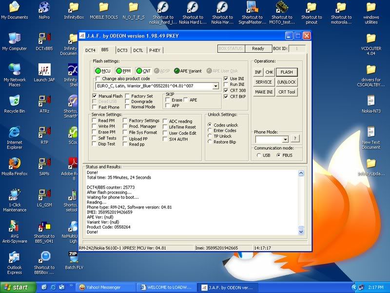

Problem: 5610-d Express Music when powered-up after nokia logo and connecting hands appear, unit shuts down and restarts.
Action taken: full flash with jaf.

Asic ID: 000000010000022600010006010C192101003000
Asic Mode ID: 00
Asic EM ID: 00000B22
Asic Public ID: 0BF00019F6660254290A1AA4B3C87294B9416EF1
HASH: BAF3A9C3DBFA8454937DB77F2B8852B100000000
ROM ID: 273F6D55DFAAF68F
CMT Boot File: C:\Program Files\ODEON\JAF\Flash\rap3gv3_2nd.fg
Loader version: 01.1E.00 -> Revision: 0000
Patching CMT boot step1...
Patching CMT boot step2...
Patching CMT boot step3...
CMT Boot Ready
CMT Flash ID: 220C00EC <=> SAMSUNG (SEC) -> K5G1257ATM
CMT Flash Data: 00000000000000000000000000000000
CMT Loader: C:\Program Files\ODEON\JAF\Flash\RAP3Gv3_algo.fg
Loader version: 01.21.01 -> Revision: 0000
Patching CMT loader step1...
Patching CMT loader step3...
CMT Loader Ready
Operation took 0 minutes 5 seconds...
Stage 1
FAST MODE finish!
Operation took 4 minutes 49 seconds...
Reseting phone...
CNT: C:\Program Files\Nokia\Phoenix\Products\Products\RM-242\rm242__04.81_ISM_007.image_blue_c
Booting phone...
FAST PHONE detected!
CMT Boot Data:
Asic Mode ID: 00
CMT Boot Ready
CMT Loader Ready
No convertion block detected or file already converted.
Erasing...
Operation took 1 minutes 43 seconds...
Writing...
Stage 1
Booting phone...
CMT Boot Data:
Asic Mode ID: 00
CMT Boot Ready
CMT Loader Ready
Stage 1
Booting phone...
CMT Boot Data:
Asic Mode ID: 00
CMT Boot Ready
CMT Loader Ready
Stage 1
Booting phone...
CMT Boot Data:
Asic Mode ID: 00
CMT Boot Ready
CMT Loader Ready
Stage 1
Booting phone...
CMT Boot Data:
Asic Mode ID: 00
CMT Boot Ready
CMT Loader Ready
Stage 1
Booting phone...
CMT Boot Data:
Asic Mode ID: 00
CMT Boot Ready
CMT Loader Ready
Stage 1
FAST MODE finished!
Operation took 12 minutes 3 seconds...
Reseting phone...
Done!
Total time: 35 Minutes, 24 Seconds
DCT4/BB5 counter: 25773
After flash processing...
Waiting for phone to boot...
Reading...
Phone type: RM-242, Software version: 04.81
IMEI: 358952019426659
APE Ver: (null)
Variant Ver: (null)
Product Code: 0558264
Done!
