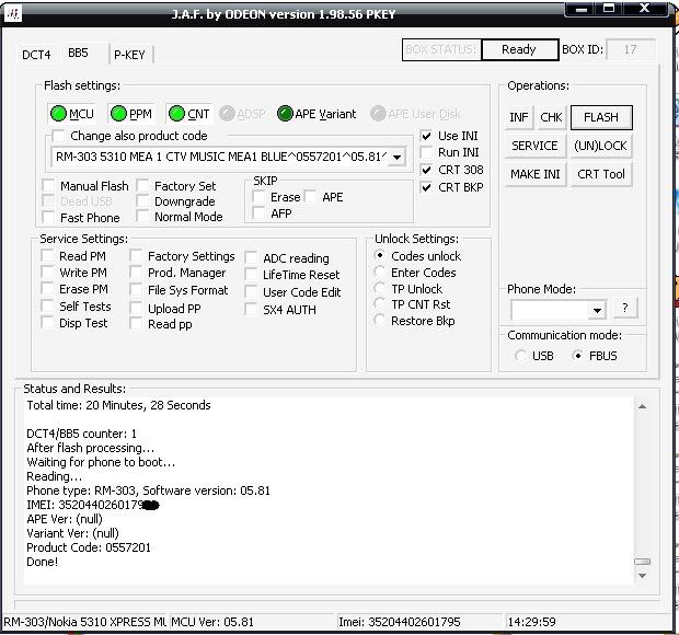

operation logs:
JAF version 1.98.56
Detected PKEY:kungpaoski
Card life counter: 43.86%
P-key nokia module version 01.02
Detected UFS_USB V2.8 (c) SarasSoft 2007. version: 01.B0, Driver version: 0, Library version: 0
JAF DCT4/BB5 LOADERS DIR: C:\Program Files\ODEON\JAF\Flash\
JAF DCT4/BB5 PRODUCT DIR: C:\Program Files\Nokia\Phoenix\Products\
JAF USB LOADERS DIR: C:\Program Files\ODEON\JAF\FlashUSB\
JAF DCT3/DCTL LOADERS DIR: C:\Program Files\ODEON\JAF\Flash3\
USB Cable Driver version: 7.0.2.0
Changing mode...Done!
Booting phone...
FAST PHONE detected!
CMT Boot Data:
Asic ID: 000000010000022600010006010C192101013000
Asic Mode ID: 00
Asic EM ID: 00000B22
Asic Public ID: 17700204887A02547905ED586F9B4C216B9AAC36
HASH: BAF3A9C3DBFA8454937DB77F2B8852B100000000
ROM ID: 273F6D55DFAAF68F
CMT Boot File: C:\Program Files\ODEON\JAF\Flash\UFS\rap3gv3_2nd.fg
Loader version: 01.10.02 -> Revision: 0000
Patching CMT boot step1...
Patching CMT boot step2...
Patching CMT boot step3...
CMT Boot Ready
CMT Flash ID: 220C00EC <=> SAMSUNG (SEC) -> K5G1257ATM
CMT Flash Data: 00000000000000000000000000000000
CMT Loader: C:\Program Files\ODEON\JAF\Flash\UFS\RAP3Gv3_algo_fps8.fg
Loader version: 01.0C.05 -> Revision: 0000
Patching CMT loader step1...
Patching CMT loader step3...
CMT Loader Ready
Done!
Restarting phone...Done!
FILES SET FOR FLASHING:
MCU Flash file: NONE
PPM Flash file: NONE
CNT Flash file: NONE
APE Variant file: NONE
Switching to serial...
Powering the phone...
Reading...
MCU SW version: V 05.81
06-02-08
RM-303
(c) Nokia
HW version: 2006
PCI version:
RFIC version:  064c0609
DSP version: ICPR71_08w03_3
LCD version: SEIKO
PPM version: V 05.81
06-02-08
RM-303
(c) Nokia
M1
Retu version: 15
Tahvo version: 22
Content Pack version: Content: ctv_mea1_music_blue
V 05.81
06-02-08
RM-303
(c) Nokia
Production serial number: KJR222123
Product code: 0557201
Module code: 0203414
Basic production code: 0544850
Flash code:
Order number:
Product specific data:
Long production SN: 0
ATO:
Default SN type:
IMEI plain: 352044026017956
IMEI spare to net: 3A 25 40 04 62 10 97 05
IMEI SV to net: 33 25 40 04 62 10 97 25 F7
LOCK STATUS:
CONFIG KEY: 0000000000000000
PROVIDER KEY: 2440700000000000
Provider: AT&T;U.S.A. (3650)
Key Code count: 0, FBUS Code count: 0
Block 1:
Lock 1: OPEN Lock 2: OPEN Lock 3: OPEN Lock 4: OPEN Lock 5: OPEN
Block 2:
Block 3:
Block 4:
Block 5:
Block 6:
Block 7:
Searching for saved ini...
Checking for file C:\Program Files\ODEON\JAF\JAF_RM-303.ini
Saved INI not found, loading INI list...
Setting local mode...
Reading product code...
Product Code: 0557201
MCU Flash file: C:\Program Files\Nokia\Phoenix\Products\RM-303\rm303__05.81.mcusw
PPM Flash file: C:\Program Files\Nokia\Phoenix\Products\RM-303\rm303__05.81.ppm_m1
CNT Flash file: C:\Program Files\Nokia\Phoenix\Products\RM-303\rm303__05.81.image_ctv_mea1_music_blue
Languages in ppm: English,French,Arabic
Done!
Backing up CRT data...
Setting FLASH MODE
CMT Boot Ready
CMT Loader Ready
Reading CMT NPC certificate...
Reading CMT VARIANT certificate...
VARIANT CRT not available...
Reading CMT CCC certificate...
Reading CMT HWC certificate...
Saved to C:\Program Files\ODEON\JAF\ProgData\35204402601795_CRT_backup_147208.rpl
Backup CRT OK!
Backing up SIMLOCK data...
Reading IMEI...
C:\Program Files\ODEON\JAF\ProgData\352044026017956_CRT_backup_149208.pm
Done!
Backup LCK OK!
Reading SW version...05.81
Booting phone...
CMT Boot Data:
Asic Mode ID: 00
CMT Boot Ready
CMT Loader Ready
Operation took 0 minutes 8 seconds...
Sending CRT data...
No convertion block detected or file already converted.
Erasing...
Operation took 0 minutes 48 seconds...
Writing...
Stage 1
Sending CMT HASH for NOLO
Sending CMT HASH for KEYS
Sending CMT HASH for PRIMAPP
Sending CMT HASH for PASUBTOC
Sending CMT PUB KEYS...
Sending CMT HASH for UPDAPP
Sending CMT HASH for DSP0
Sending CMT HASH for MCUSW
Error resetting phone...
Booting phone...
CMT Boot Data:
Asic Mode ID: 00
CMT Boot Ready
CMT Loader Ready
Operation took 0 minutes 7 seconds...
Sending CRT data...
Stage 1
Booting phone...
CMT Boot Data:
Asic Mode ID: 00
CMT Boot Ready
CMT Loader Ready
Sending CRT data...
Stage 1
Booting phone...
CMT Boot Data:
Asic Mode ID: 00
CMT Boot Ready
CMT Loader Ready
Sending CRT data...
Stage 1
Booting phone...
CMT Boot Data:
Asic Mode ID: 00
CMT Boot Ready
CMT Loader Ready
Sending CRT data...
Stage 1
FAST MODE finish!
Operation took 9 minutes 58 seconds...
Reseting phone...
PPM: C:\Program Files\Nokia\Phoenix\Products\RM-303\rm303__05.81.ppm_m1
Booting phone...
CMT Boot Data:
Asic Mode ID: 00
CMT Boot Ready
CMT Loader Ready
Erasing...
Operation took 0 minutes 15 seconds...
Writing...
Stage 1
Booting phone...
CMT Boot Data:
Asic Mode ID: 00
CMT Boot Ready
CMT Loader Ready
Stage 1
FAST MODE finish!
Operation took 2 minutes 52 seconds...
Reseting phone...
CNT: C:\Program Files\Nokia\Phoenix\Products\RM-303\rm303__05.81.image_ctv_mea1_music_blue
Booting phone...
CMT Boot Data:
Asic Mode ID: 00
CMT Boot Ready
CMT Loader Ready
Erasing...
Operation took 1 minutes 50 seconds...
Writing...
Stage 1
Booting phone...
CMT Boot Data:
Asic Mode ID: 00
CMT Boot Ready
CMT Loader Ready
Stage 1
Booting phone...
CMT Boot Data:
Asic Mode ID: 00
CMT Boot Ready
CMT Loader Ready
Stage 1
FAST MODE finished!
Operation took 4 minutes 9 seconds...
Reseting phone...
Done!
Total time: 20 Minutes, 28 Seconds
DCT4/BB5 counter: 1
After flash processing...
Waiting for phone to boot...
Reading...
Phone type: RM-303, Software version: 05.81
IMEI: 352044026017956
APE Ver: (null)
Variant Ver: (null)
Done!
5310 express music restart problem repair/flash done

CMT Flash Data: 00000000000000000000000000000000 try to flash hayer ver flash file
and plane rpl
