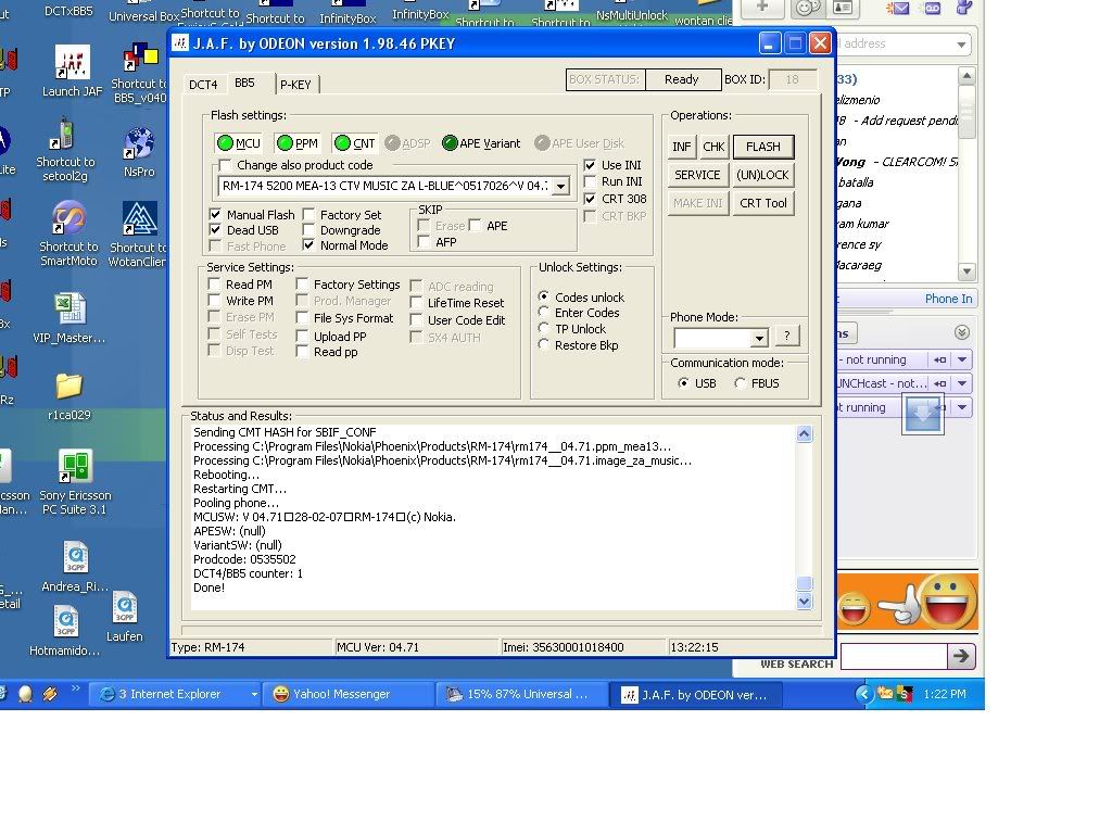

PROBLEM: 5200 HANGS-UP WHEN YOU PRESS MENU KEY
ACTION TAKEN: FIRST TRIED CLEANING KEYPAD BOARD CONTACTS. sTILL SAME PROBLEM. sO DECIDED TO FLASH IT WITH JAF VIA DEAD USB FLASHING JUST FOR KICKS. THAT SOLVED THE PROBLEM.
FLASHING LOGS:
Searching for phone...Detected P-KEY: 90008888
P-key nokia module version 01.00
Init usb communication...
Found
Starting DEAD USB phone flashing...
Using 06.02.002
    Elf2flash 02.33.000 RAW loader...
Patching RAW boot step1...
Patching RAW boot step3...
Sending RAW Loader...
...................Loader Sent!
Stage 2 starting.............................................................Loader Sent!
Stage 3 starting..................Phone prepared OK!
Waiting for the phone to boot...
Searching phone...Found!
Status byte: 04
Phone is in flash mode...
CMT blocks: 1287, APE blocks: 0
Erasing cmt...
Send CMT CFG...
Processing C:\Program Files\Nokia\Phoenix\Products\RM-174\rm174__04.71.mcusw...
Erasing cmt zone 00000000 - 000006BF ...
Erasing cmt zone 000006C0 - 0001FFFF ...
Erasing cmt zone 00020000 - 0007FFFF ...
Erasing cmt zone 00080000 - 000DFFFF ...
Erasing cmt zone 00100000 - 001FFFFF ...
Erasing cmt zone 00200000 - 0031FFFF ...
Erasing cmt zone 00320000 - 0105FFFF ...
Erasing cmt zone 01060000 - 01067FFF ...
Erasing cmt zone 01068000 - 0107FFFF ...
Processing C:\Program Files\Nokia\Phoenix\Products\RM-174\rm174__04.71.ppm_mea13...
Erasing cmt zone 01080000 - 014FFFFF ...
Processing C:\Program Files\Nokia\Phoenix\Products\RM-174\rm174__04.71.image_za_music...
Erasing cmt zone 01500000 - 01FDFFFF ...
Writing cmt...
Sending CMT HASH for NOLO
Sending CMT HASH for KEYS
Sending CMT HASH for PRIMAPP
Sending CMT HASH for PASUBTOC
cmt->PAPUB_CERTIFICATE_DATA_BB5 block detected
cmt->PAPUB_CERTIFICATE_DATA_BB5 block detected, sending...
Sending CMT HASH for UPDAPP
Sending CMT HASH for DSP0
Sending CMT HASH for MCUSW
Sending CMT HASH for PMM_CONF
Sending CMT HASH for SBIF_CONF
Rebooting...
Restarting CMT...
Pooling phone...
MCUSW: V 04.71
28-02-07
RM-174
(c) Nokia.
APESW: (null)
VariantSW: (null)
Prodcode: 0535502
DCT4/BB5 counter: 1
Done!
