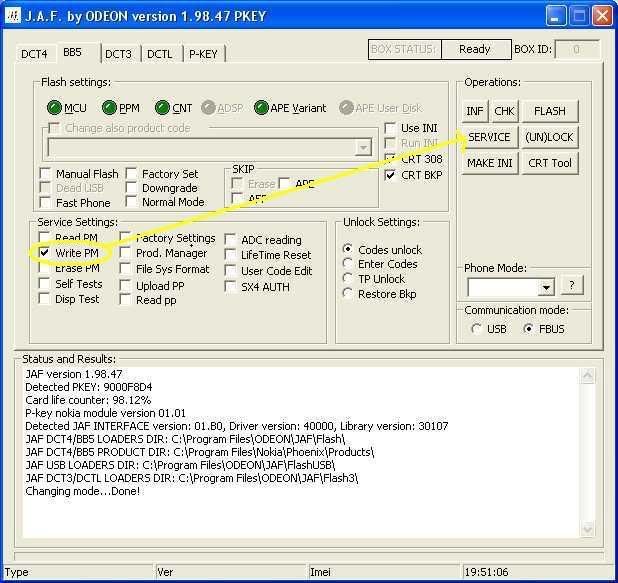

1- Flash The Unit
2- Write PM using "SX4 AUTH" in JAF

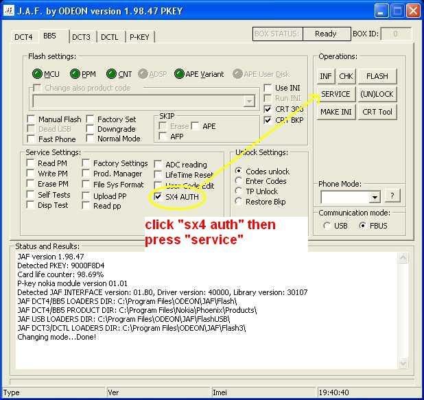

HOW TO USE SX4 AUTH:
1- Click "SX4 AUTH" and press the "SERVICE BUTTON" as seen in the pic:
2- After you see "COMMUNICATION DONE" you can now write PM Values, refer to pics below:
3- Your done...
