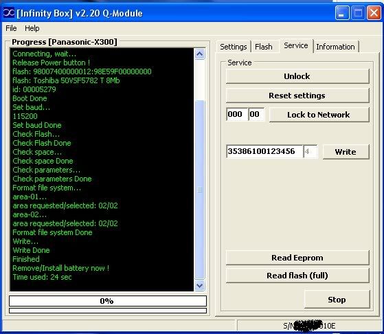

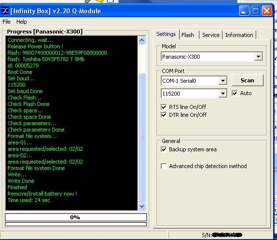

problem: panasonic x300 when powered-up hang in start-up logo
action taken: read fullflash first for back-up then tick reset settings
After reset settings with infinity. press power button, hold power on button until unit shows menu. don't release power button until menu is displayed.
