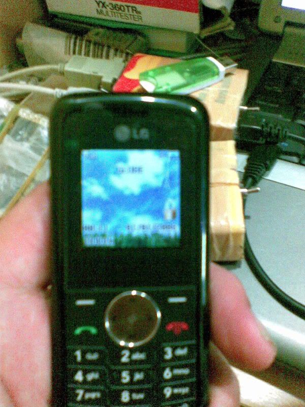

Lg kp100 revived by infinity..

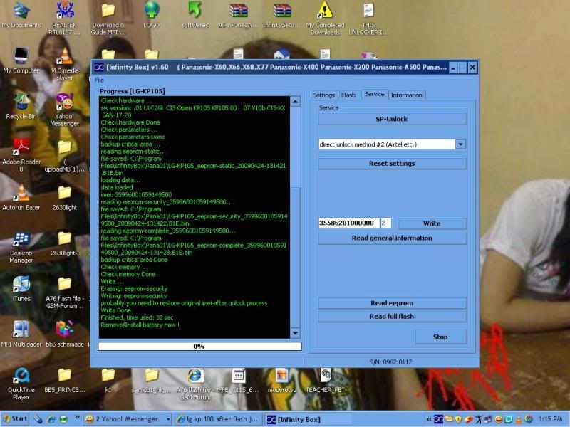

first i used vygis, phone revived but blinking status i flashed many times but no luck .. i turn to fg still the same blinking i decide use infinity and finally done !
download any firmware kp100 or k105 and eeprom from infinty support this firmwares is same you can use this in both model..the firmware i used
KP105+00V10b+CI5-XX-JAN-17-2008+0_firmware_lp.B1M
KP105_repair_eeprom_01.b1E
open infinity select kp100 or kp105 model then run
put firmware and eeprom
use rj45 kg800 cable
then hit write wait till phone flashing done
if still blinking status heres final solution
go to sp unlock select
direct unlock method #2(airtel etc) viola!!
thanks to infinity team for quick response..
