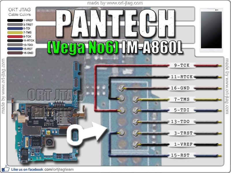

SKY IM-A860L / Pantech Vega N6 Repair Dead Boot
Reply #63 on:
December 09, 2013, 10:50:14 AM »
ORT - JTAG UPDATE
[09 December 2013]
Description :
SKY IM-A860L Repair Boot Supported
Release Notes and Files:
SKY_IM-A860L Pinouts
SKY_IM-A860L.dll
Repair Dead Boot
Repairing SKY IM-A860L
Connect Battery and USB Cable
Download DLL File "SKY_A860L.dll"
Place in phones folder
Start ORT Plus Latest Version
Go to Easy Mode
Select Model
Click Repair
Pinouts :
