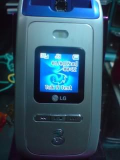

1. Flash using special file from support (U890_64K_SIM_EASY_TEMPUNLOCK.sex)
2. Detach phone from usb cable
3. Insert orginal simcard or any sim card accepted by phone
4. Put the usb cable or charger (phone start charging)
5. Wait 10 sec then power on the phone.
6. Go in phone menu at 'unit converter' (the phone will restart)
7. Quickly remove battery, change current sim with other one (64k, 128k) and put battery back and wait.
P.S: if phone results on 'no network' then write nv file for u890 from support and
then repeat the procedure from 2 to 7.[/
I]
[/SIZE]
This temporary unlock only not permanent unlock.
