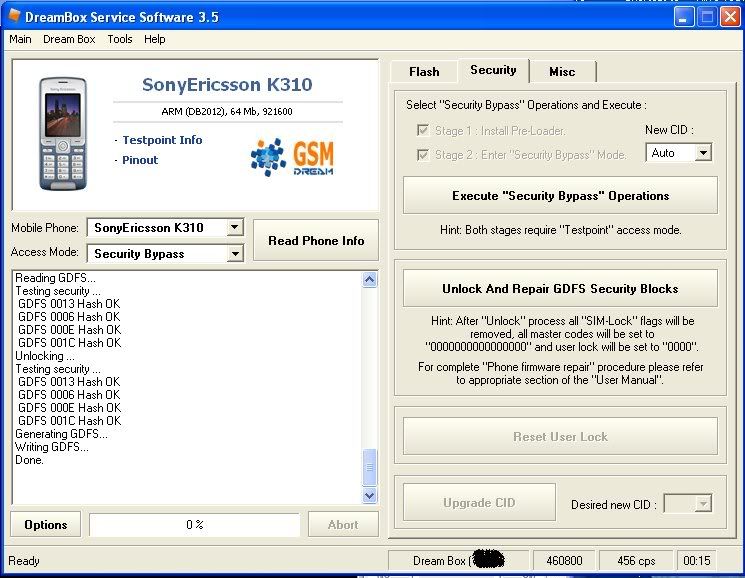

logs:
--- Security Bypass------------------------------------------------------------
User selected phone K310 using Test Point boot mode
Stage 1 started
1) Turn OFF the phone.
2) Connect the phone to DreamBox cable.
Boot Responce = 5A
Processor ID = 8040030101010101 (DB2012 R3A)
Warning : Detected platform is different from selected
EROM Color = 4 : RED
EROM CID = 50
NOR Flash ID = 897E
OTP Status = LOCKED
OTP IMEI = 357275-01-516817-9
OTP CID = 50
EROM CID = 50
Hint : Now the probe might be disconnected
Processing ...
Stage 1 completed succesfully
Stage 2 start
Processing...
Entering Security Bypass mode ...
Boot Responce = 5A
EROM CID = 50
Baseband Chip ID = 8040
Phone ID = 22809B7315102D7E
Finalizing ...
Stage 2 completed succesfully
Done.
--- Unlock and Repair----------------------------------------------------------
User selected phone K310 using Security Bypass boot mode
Boot Responce = 5A
EROM CID = 50
Reading GDFS...
Testing security ...
 GDFS 0013 Hash OK
 GDFS 0006 Hash OK
 GDFS 000E Hash OK
 GDFS 001C Hash OK
Unlocking ...
 GDFS 0013 Hash OK
 GDFS 0006 Hash OK
 GDFS 000E Hash OK
 GDFS 001C Hash OK
Generating GDFS...
Writing GDFS...
Done.
K310i cid 50 Sun sim-locked unlock done
